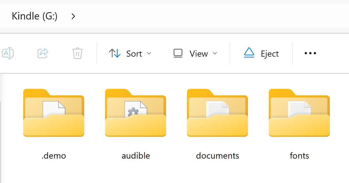

Old 10-28-2023, 08:52 AM   #64
litrpguy
litrpguy began at the beginning.
Posts: 39
Join Date: May 2020
Device: Kobo Clara HD, PB Color, PB Inkpad Color, PB Touch Lux 5
Originally Posted by Marek View Post
I'm still looking into making this part of the hotfix but, i will at least add this to the original post
Sorry to bother again man, just to confirm after jailbreak and exiting demo mode and reverting to english, this is the expected folders on kindle right? A bit confused since voyage has a lot of folders after the jailbreak.
litrpguy is offline   Reply With Quote
as long as you saw the log after doing the jailbreak you should be fine and can install the hotfix
Marek is offline   Reply With Quote
