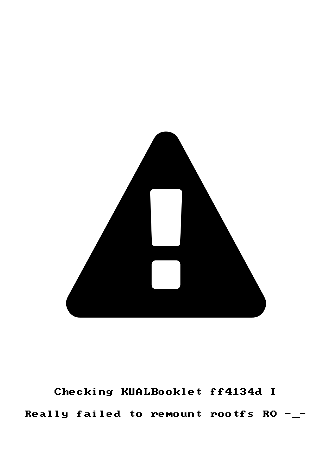

Unhappy
Originally Posted by guio View Post
@hartleyshc, how did you manage to install KUAL and Koreader?
I've tried over mrpi but I had an error like "Coudn't mount system RO"
I have the same problem.
Mine is Kindle PW3,
I tried to install Update_KUALBooklet_v2.7.29_install.bin via MRPI as the tutorial,
got the error message "Failed to remount roofsro" and nothing was installed.
Also, after I updated update_hotfix_languagebreak.bin and rebooted, Kindle is still in Chinese, and the Languages setting is locked saying something "you need to contact your administrator.". Under the Device Info, the last item says "Demo".
Is it still in Demo mode and the hotfix had failed to quit it?
Edit: saw Marek's post, "Go back to demo mode with ;demo -> right button it should reset and you should be out of demo and in English". However, still no luck on installing Kual.

Marek
Mine is Kindle PW3,
Same error here.
Bella is offline   Reply With Quote
