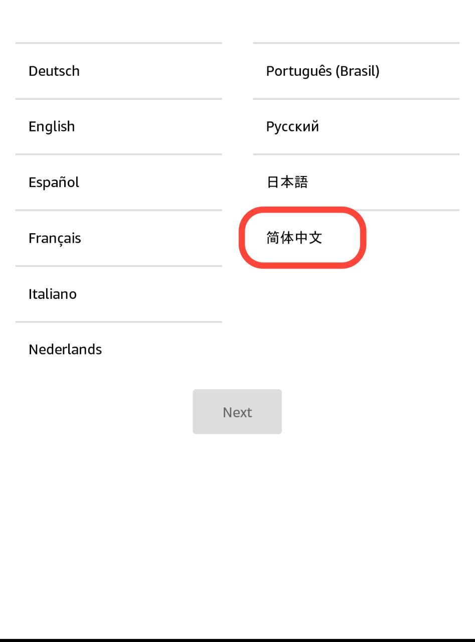

Hello,
i tried multiple times on a Paperwhite Signature 11th edition, 5.16.2.1. After the Power on screen, i can connect the PC, but dont get a device to copy files to.
Tried like Bella and ignore it, seems not to work for me. Maybe wrong language, which is meant here with pseudodot language? I get a list of languages, the last 2 on the right side are chinese symbols, i dont know which is right. Tried the upper one, but it did nothing.

Originally Posted by DarkWolf View Post
Hello,
The top one is Japanese and the bottom one is Chinese. I clicked on the bottom one.
