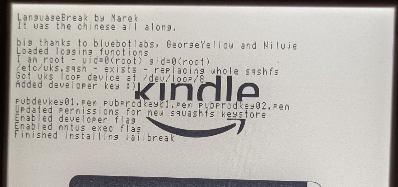

Join Date: Oct 2023
Device: Paperwhite 3
I managed to do it on a pw3! I skipped step 15 because my Kindle restarted before I could copy the files. But it ended up working out anyway. It is not possible to install KUAL yet.
Thank you very much!
