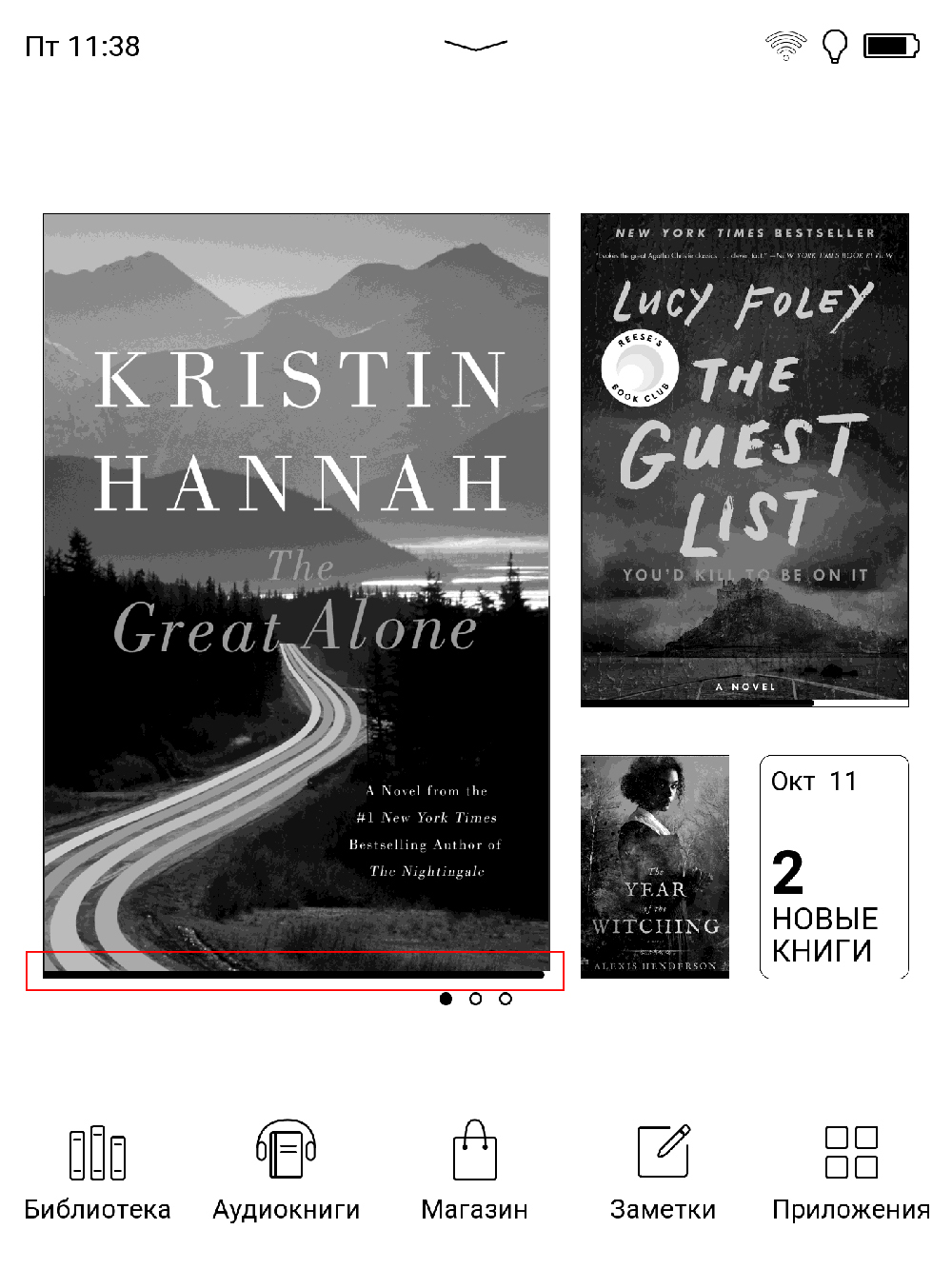

Hi. If an epub book contains non-linear fragments and the “hide non-linear fragments” option is enabled in the koreader, then the book is not marked as readed at the end
I implemented a fix for this in my fork of the plugin: https://github.com/liskin/koreader-p...48a9ae7a70fd7b
Can you test this please?
https://github.com/liskin/koreader-p...ae7a70fd7b.zip is the version with all my fixes.

Thank you. The book is marked as read in the library, but on the home page the progress bar does not reach 100%
