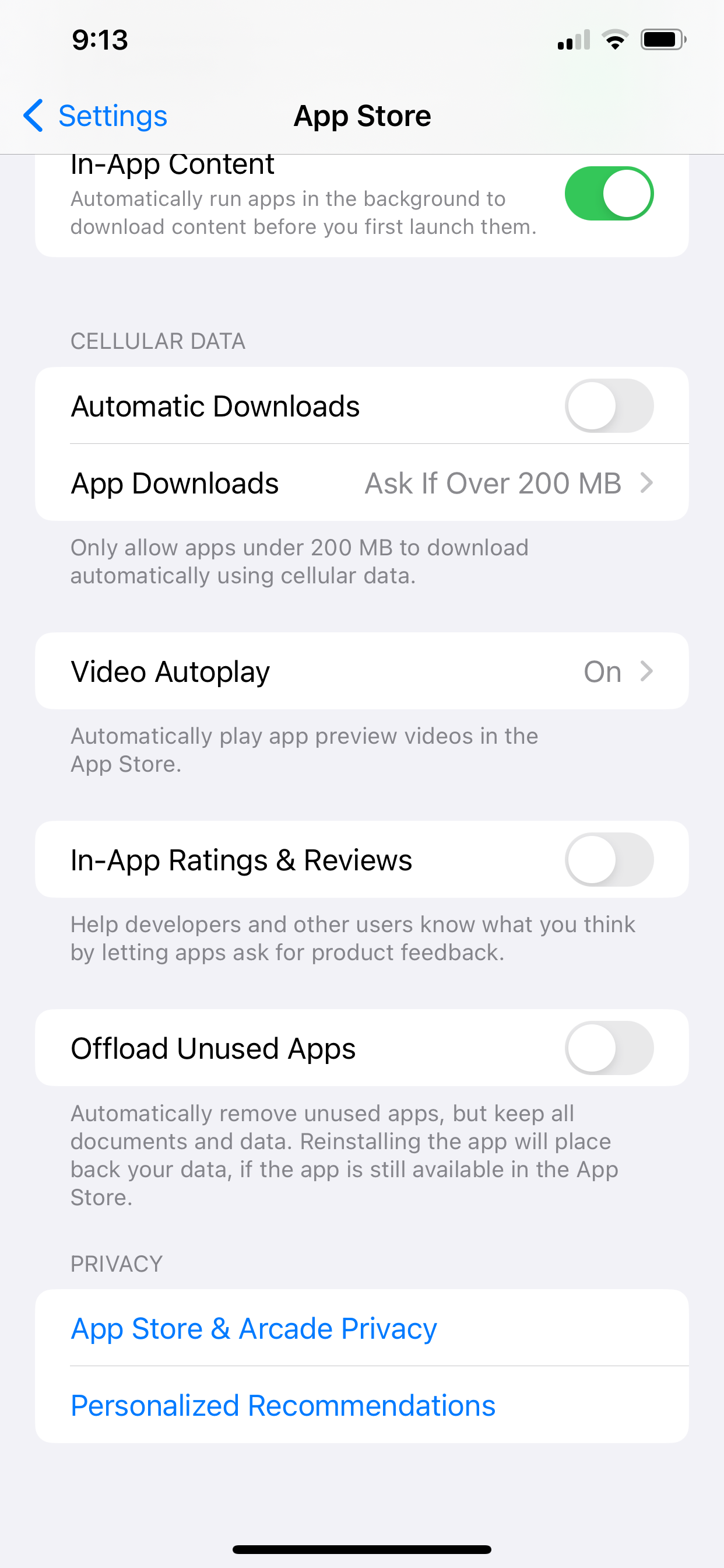

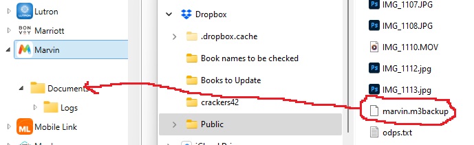

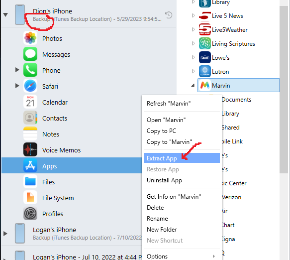

For anyone as ignorant uninformed as I was, here are a few steps to reinstall Marvin even though it is no longer available on the Apple store:
1) Download and install iMazing. I was able to do this with the free version of iMazing although there was a report here that you needed the paid version, ymmv.
2) Follow the directions in this video to install Marvin.
  • you either need to have a current version of Marvin installed on another device to extract the .ipa file ---OR--- you can extract the "Marvin.imazingapp" file from an older iOS backup!!

Steps 3 and 4 are optional if you want to restore books from a Marvin backup.
3) Once you have Marvin installed you can use imazing to drag your marvin.m3backup file (the backup of epubs that Marvin makes) to your documents folder in Marvin.

I HIGHLY recommend going into your iThing settings and DISABLE Apple's 'feature' to offload unused apps.
6) goto iOS settings, scroll down to "App Store" and deselect (turn off) "Offload Unused Apps". Be aware you will be responsible for removing any apps you don't want if you start running out of space on your iThing.
