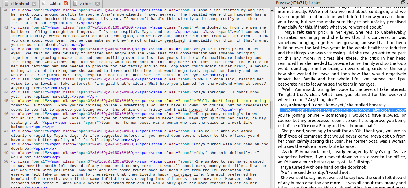

Why are my tab spaces not uniform?
Hi, I have a question about the tab spaces at the beginning of paragraphs.
In the Word doc, I set the paragraph tabs to 0.50 cm and in Sigil I'm using three spaces.
However, the spaces are not uniform throughout the whole document. Sometimes the space before the first word of the paragraph is larger, although the code is exactly the same. See screenshot for what I mean.
Can anyone help?
Thanks,
Helen

You don't want tabs as indents. You want to use a text-indent in CSS. Forget the class para1. You do not need it. Use just <p> for the standard indented paragraphs. Here is some CSS that will do the job and do it well. Also get rid of the spans with span3 and get rid of the tabs.

To answer the question in the title: Because with justified lines the spaces can stretch or shrink to adjust the line length, like any other space between words.
The solution is: either don't justify or (recommended) use text-indent, which is what you actually want.
Thanks - that explains it perfectly. I hadn't thought of that. Doh!
CSS
p {
margin-top: 0;
margin-bottom: 0;
text-indent: 0;
Thanks, that helps a lot. Sorry to ask again (I'm not that great with code), but I want the first paragraph of each chapter to NOT be indented. How do I get around that? Do I need to use a <div> for those paragraphs?

JSWolf, please ignore my last comment. I've worked it out - I've used <p class="firstpara">

.firstpara {
  text-indent: 0;
