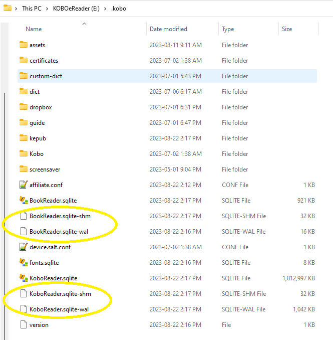

One quick question: when you connect your Forma to your computer and get the database issue, can you open a file explorer and look at the .kobo directory on your Forma. If you see files such as KoboReader.sqlite-wal and KoboReader.sqlite-shm or BookReader.sqlite-wal and BookReader.sqlite-shm, the database is not being properly closed before the USB connection. See the attached image for what I see on one of my Kobos when the problem shows up.
My workaround for this has been to use NickelMenu to trigger a reboot before the USB connection for ensure that the database files are closed.
I wouldn't bother looking for issues due to metadata, etc. on your computer.
Tried rebooting and worked like a charm; thank you so much! I was looking through the most recent firmware update thread and thought it could be because of the USB files not closing bug, but I wasn't sure how to fix it until now.

Yeah, I do the same thing DNSB does, I start the reboot (I have it on my nickelmenu) and then plug in the usb. Seems to work flawlessly when I do that.

I don't reboot. I go to the Home screen before I connect my Libra 2 to the computer.
