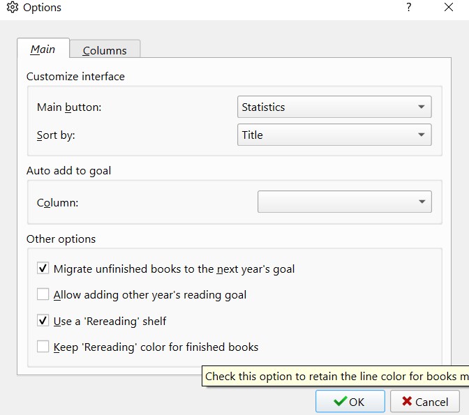

Old 10-04-2023, 04:28 PM   #296
Tiffisters
Tiffisters began at the beginning.
Posts: 4
Join Date: Oct 2023
Device: Kobo Libre 2
Error: Invalid Argument
Hiya!
Ive been overhauling my Calibre the past few days and I'm getting an error when I try to do anything with the Reading Goal plugin
calibre, version 6.27.0
ERROR: Unhandled exception: <b>OSError</b>:[Errno 22] Invalid argument
calibre 6.27 embedded-python: True
Windows-10-10.0.19045-SP0 Windows ('64bit', 'WindowsPE')
('Windows', '10', '10.0.19045')
Python 3.10.1
Windows: ('10', '10.0.19045', 'SP0', 'Multiprocessor Free')
Interface language: None
Successfully initialized third party plugins: Author Book Count (2, 2, 3) && Count Pages (1, 13, 2) && Goodreads (1, 7, 9) && Goodreads Sync (1, 16, 3) && Goodreads_Rating (4, 0, 0) && Kobo Books (1, 9, 2) && Kobo Utilities (2, 16, 10) && KoboTouchExtended (3, 6, 6) && Reading Goal (1, 2, 1)
File "calibre_plugins.Reading_Goal.main", line 194, in manage_reading_goal
File "calibre_plugins.Reading_Goal.main", line 254, in add_to_goal
File "calibre_plugins.Reading_Goal.main", line 1029, in get_book_info
OSError: [Errno 22] Invalid argument
If I could get some assistance on what I am doing wrong, it would be much appreciated! I love this idea and got the Count Pages set up specifically to track with this

Old 10-04-2023, 06:51 PM   #297
thiago.eec
Posts: 1,321
Karma: 1436993
Join Date: Dec 2016
Location: Goiânia - Brazil
Check your date column. You probably have an invalid date in one of your books (like 1900 or something). If you have a date before the python epoch time (1970 if I'm not mistaken), you get this error.

Old 10-04-2023, 07:07 PM   #298
Comfy.n
want to learn what I want
Posts: 2,001
Karma: 7955879
Join Date: Sep 2020
FWIW, I remember this epoch time thing being discussed here:
https://bugs.launchpad.net/calibre/+bug/2028019
https://github.com/kovidgoyal/calibr...9495d2d4b94f74
Old 10-04-2023, 07:22 PM   #299
thiago.eec
Posts: 1,321
Karma: 1436993
Join Date: Dec 2016
Originally Posted by Comfy.n View Post
Exactly. This error is related to the astimezone() method. This method converts a naive date to a timezone aware date, so your dates are saved with the correct UTC offset. But it fails for dates before 1970.
But I think this is just an incorrect date (I hope), since the user probably does not have records going back to the 70's.
thiago.eec is offline   Reply With Quote
Old 10-04-2023, 07:52 PM   #300
ownedbycats
Custom User Title
ownedbycats's Avatar
Posts: 11,596
Karma: 81412473
Join Date: Oct 2018
I do occasionally change the date of my unreads to 1970/01/01 in order to fix the weird sorting of books on my Kobo, but I clear it when I'm done. (Though sometimes I use 2000/01/01 instead.)
