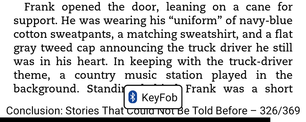

Originally Posted by akadaedalus View Post
I applaud your creative "laziness".
It's not perfect because there are like 10 steps to take to exit the book, turn on bluetooth, pair the ring, and go back to the book.
Huh? I just leave Bluetooth on all the time.
It's not like WiFi sucking the electrons out of your battery.
I open the cover on my book and hit a (any) button on my remote.
At that point a tiny popup (Toast) shows that says that it's connected.
The next button does what it should.
If I fall asleep everything shuts down.
The same is true for my foot pedals.
I don't turn them off, just hit something when I want to use them.
When I'm done I just push them out of the way.
