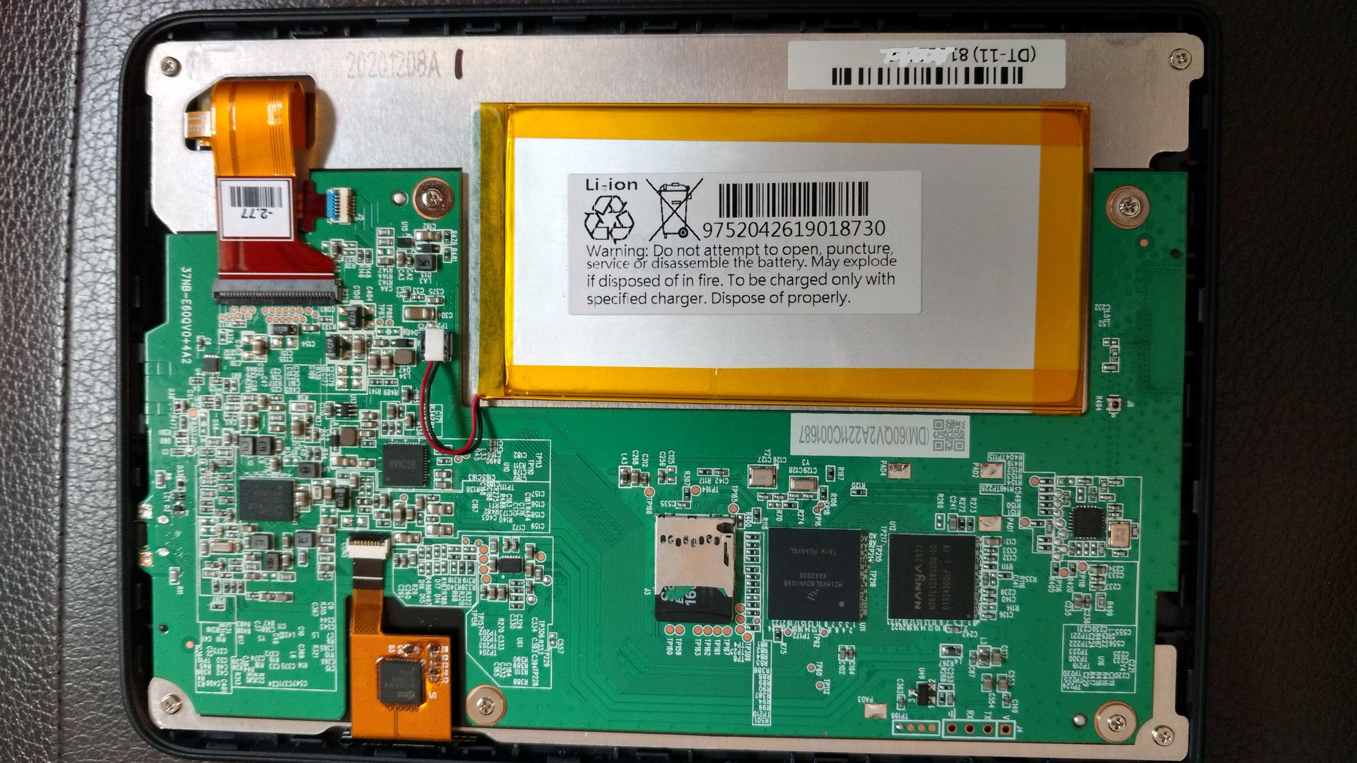

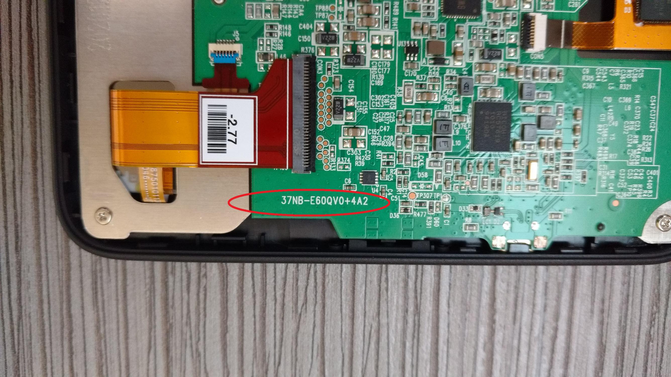

Originally Posted by kenta9x View Post
brother, I can't find a private message section to text you. Sorry.
I downloaded the img file you sent me, but I'm not sure if I wrote the img file to the sd card properly, it doesn't work on my 32GB sd card. I inserted it into tolino page 2 and it couldn't work, but when I reinserted the old SD card, the device worked normally again. do you have telegram?
“Tolino_Page_2_2021.img” works, I checked it. Either you wrote Image incorrectly on the card, or you may have a different version of Page-2.
ID:	203921 Click image for larger version
But I'm not sure if my image will help solve your problem.
Attachment 203921 Attachment 203922
This my devices !!!
Can you guide me how to write image files??? Can I use a 32GB SD card????
