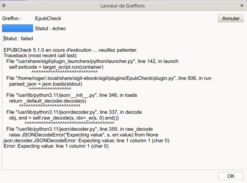

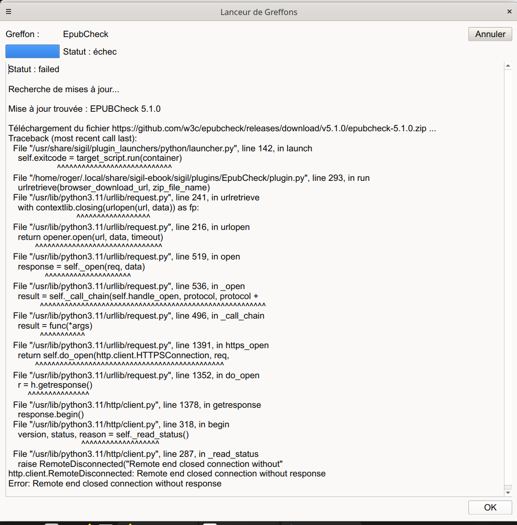

Hi
It seems I ticked all the boxes but my EPUBcheck plugin still fails at every book with the same error message (see image below).
[roger@roger-lenovo ~]$ archlinux-java status
Available Java environments:
  java-11-openjdk
  java-21-openjdk
  java-8-jre/jre (default)
[roger@roger-lenovo ~]$ python -V
Python 3.11.6
[roger@roger-lenovo ~]$ java -version
java version "1.8.0_391"
Java(TM) SE Runtime Environment (build 1.8.0_391-b13)
Java HotSpot(TM) 64-Bit Server VM (build 25.391-b13, mixed mode)
Sigil selects automatically /usr/bin/python3 on my Preferences.
In September I had downloaded epubcheck 5.0.1. This time, it seems that I fail to download the update (5.1.0.) probably because of my current location, but nevertheless, the plugin should launch the old version.

Old 11-22-2023, 05:16 AM   #493
Doitsu
Doitsu's Avatar
Posts: 5,941
Karma: 24259515
Device: Kindle PW2
Unfortunately, I wasn't able to reproduce the problem, even when I used an external Python 3.12 interpreter.
Based on another recent post, users might get a "Remote end closed connection without response" error message, because of firewall issues.
Unfortunately, the plugin will only check that you can connect to the Internet, and if the update code fails to download the .zip file, the plugin will fail, too.
I'll try to add an error handler for this particular problem in the next plugin version.
In the meantime, please try the following:
  • Edit EpubCheck.json and change the following two values to "false":
      "update_check": false,
      "github": false,
  • Then download the latest EPUBCheck version from the Github website and extract it.
  • Go to the EpubCheck plugin folder and replace epubcheck.jar and the lib folder with the Github files.

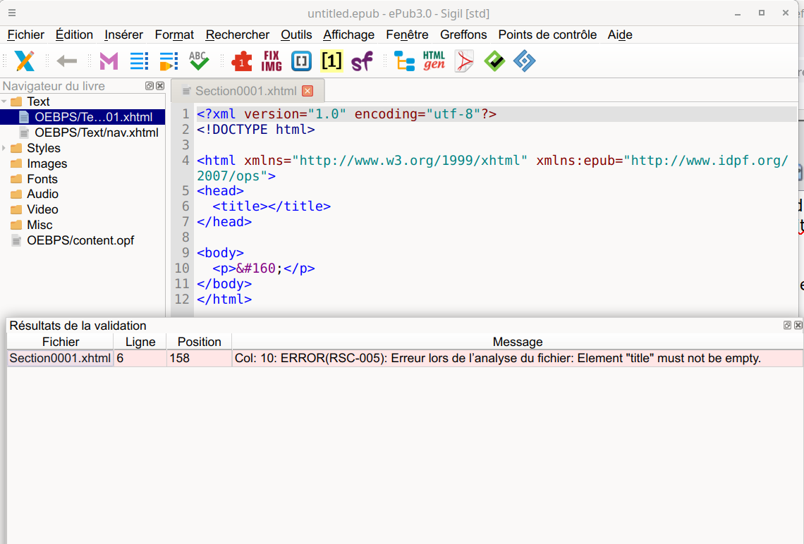

I did everything anew.
Reinstalled the 4.6.3. Sigil plugin with modified json file, managed (one hour +) to download epubcheck 5.1.0 from github and extracted it within the plugin folder.
It works when I launch it on the empty new Sigil epub (image 1) but still fails on any other epub2 or 3 (image 2) with exactly the same error message.
I may have something wrong with python.

Old 11-22-2023, 10:20 AM   #495
Posts: 85,789
Karma: 154365285
Dump the .json file and let the plugin recreate it and see if that works.
