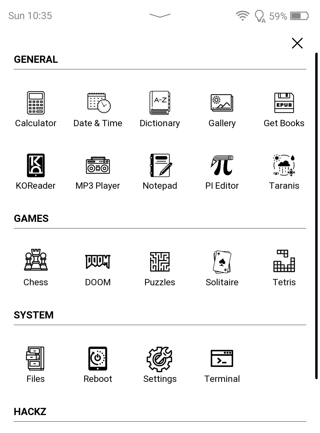

I created a couple of icons for the Taranis app so it matched my app menu.
Icons attached with a preview.
Thanks.
If I understand well, you know how to set the icon of a user application. Am I right? Do you have any pointer for that?
https://www.mobileread.com/forums/sh...=355521&page=3
Page 3, Post #33
Essentially you modify: /mnt/ext/system/config/desktop/view.json
My last post on page 4 has an attachment of some icons and the changed view.json file.
