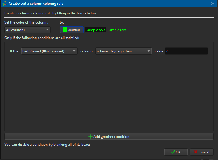

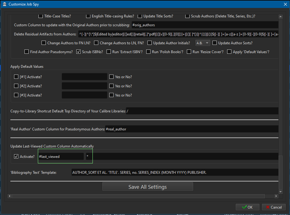

On second thought, I'd guess what you want can be achieved with Job Spy Plugin, by creating a #last_viewed date column, and assigning a coloring rule (or an emblem rule, if using the cover grid) like this:
- Job Spy:

- Coloring rule:
