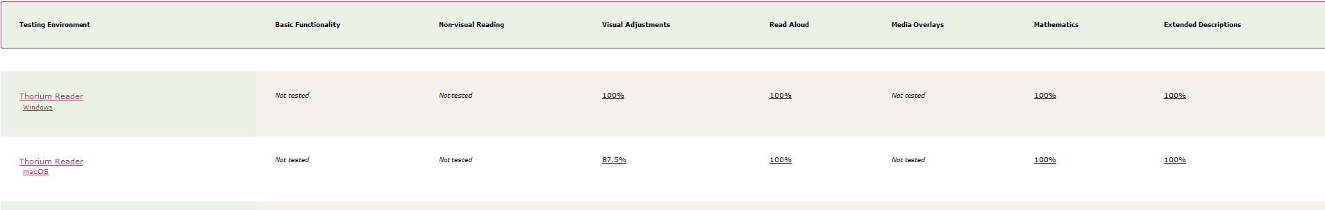

The latest version of ADE is getting better but it is not quite there yet. Also, since you posted the link to epubtest.org, did you actually take the trouble to browse that page? Digital Editions for Windows and MacOS managed 75% on visual adjustments. Compare those test results to Thorium on those OS.
For those who want to do their own testing, you can download the test books from epubtest.org and do your own tests.
