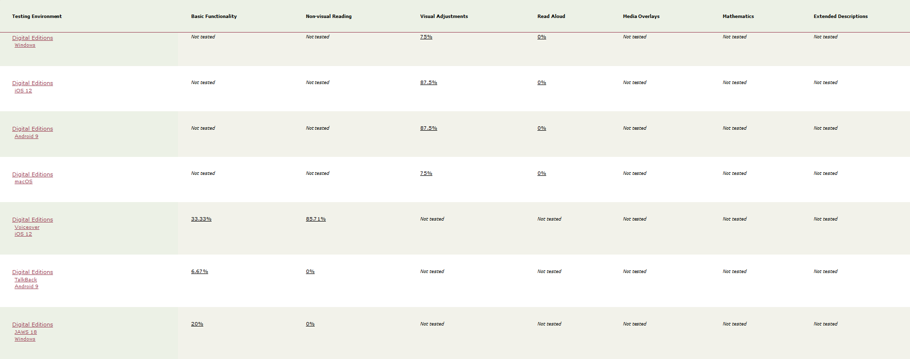

Old 08-31-2023, 09:19 PM   #119
Posts: 54,508
Karma: 182218685
A richer reading experience with EPUB 3 support
ADE is ranked among the best EPUB3 readers by EPUBTest.org. The support for EPUB 3 standard allows you a richer reading experience, including: rendering of audio and video content; support for right to left reading; dynamic image resizing without loss in clarity, interactive quizzes, better rendering of math formulas and huge improvements in support for assistive technologies.

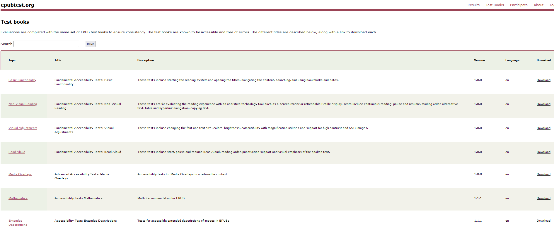

The latest version of ADE is getting better but it is not quite there yet. Also, since you posted the link to epubtest.org, did you actually take the trouble to browse that page? Digital Editions for Windows and MacOS managed 75% on visual adjustments. Compare those test results to Thorium on those OS.
For those who want to do their own testing, you can download the test books from epubtest.org and do your own tests.
