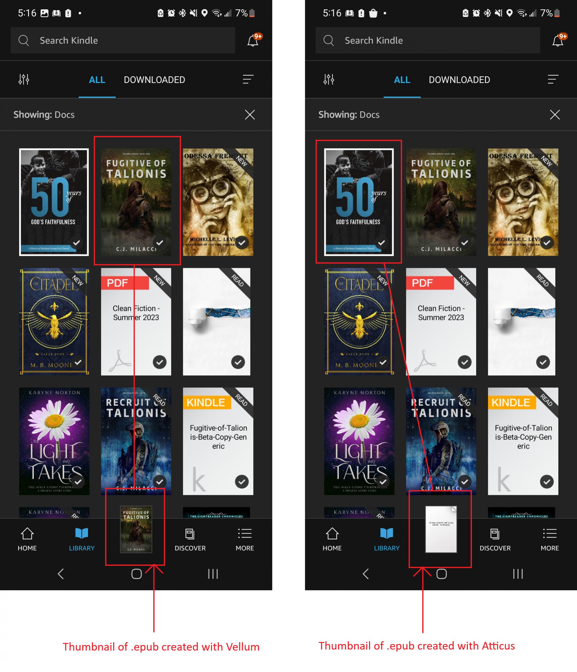

In my Android Kindle app, after opening my book and then going back to the library, the cover thumbnail isn't shown at the bottom center of the screen. However, after doing the same thing with my friend's book, her cover thumbnail is shown. (See the attached image.)
Both books were side-loaded, and my intention is that my book will always be side-loaded.
My epub was generated by Atticus. My friend's was generated by Vellum.
I compared the epubs and tried some things, including:
  • Adding the cover-image property to the cover element in my content.opf file (it had been missing)
  • Removed the '<meta name="cover" content="image_cover" />' element from my content.opf file (because Vellum's epub didn't have it)
Neither change fixed my issue.
Any ideas?

I didn't have a title page. I added one and re-exported. All the UUIDs changed. So here are all three files from the new export.
I compared my title page with my friend's title page generated by Vellum. Neither references the cover image.

Good idea. It did help the experience on non-Kindle apps because they didn't show a cover image inside the book.
Unfortunately, the Kindle thumbnail at the bottom of the app is still that white, auto-generated thing.

Mystery solved!
My cover image was too small: 550x850
Bigger images worked: 1200x1800 and also 1200x1855
