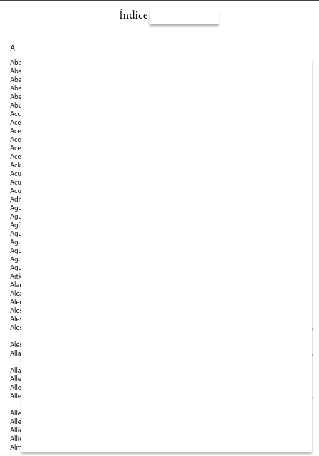

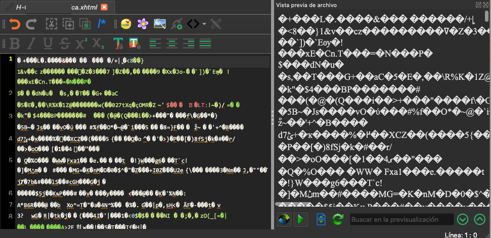

I'm having some problems concerning one .xhtml file of just one chapter in a book. When importing it to Calibre it shows as a jumbled mess of random symbols:
While on Adobe Digital Editions it looks fine before importing it to Calibre:
The chapter is a long list of names that are mentioned throughout the book, ordered alphabetically and with the page number where they're mentioned in. I just want to keep the names and ditch the numbers.
How can make it so Calibre reads this long list properly?
I tried correcting html headers and setting the whole page to utf-8 thinking it was en enconding issue but none worked.
If you'd point me in the right direction I'd appreciate it.

Rename a copy of original epub to end in .zip in a new folder.
Unpack it.
Rename the weird .xhtml file to .pdf and if that doesn't open try .png, etc. It can't be really an xhtml file unless it's encrypted.

Copied the original ePub, zipped and extracted the whole content. Then I tried changing the extension of the file to both PDF and PNG and none opened, just a white page in preview and errors when opening with a dedicated PDF app. Doing the same to the copy I imported to Calibre I'm able to read all the other chapters that are in .xhtml form inside the zip, but not the one I'm having decoding issues (even when changing it to PDF).

So it's likely an encrypted xhtml file.

Most probably, but I'm still puzzled on how the latest deDRM plugin unlocked the whole book except that one.
