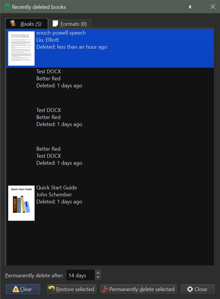

I scanned through 8 pages and didn't see an option to empty caltrash. I'm on macOS 15.5. and Calibre 8.5.
Is there a way to empty the caltrash? Or does it stay there forever?

See Remove Books->Restore recently deleted:
Name:	Screenshot 2025-06-28 163655.jpg
The Clear button deletes everything permanently, set the Permanently delete after: N days to suit your needs (soonest appears as 'on close').

Thanks. It isn' the most intuitive location, but it works! I set the retention to zero since I have 3 backups of everything and the Mac trash folder keeps deleted items for 30 days as well.
I appreciate the feature but I don't need it att.
