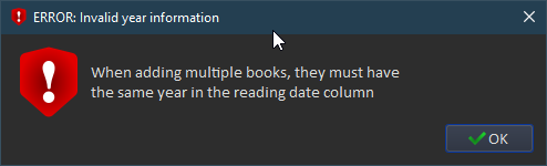

Possible timezone issue: I was adding books from December 2022. The last one was December 31 at 10:18 pm (GMT -4:00), which is 2023 in Greenwich time.
Name:	2023-08-27 22_08_02-ERROR_ Invalid year information.png
I'm aware that the date is saved to JSON in Greenwich time, but when the plugins reads it back to a datetime object, the date should be again in your timezone. I'll have to investigate this.
Just tested here and could not reproduce. I set the date as 12/31/2022 at 11:09 pm (GMT -3). Then, added to 2022 goal with no problems.
But I did noticed that this book appears on the 'Edit goal dialog' as 01/01/2023, even though it is grouped with 2022 books. This might be some problem converting a datetime object to a QDate object (Qt date object).
I'll check this soon.
EDIT.: There is something going on. First I could add, now I can't.
P.S.: Attached is a test version correcting the empty year created when adding a book fails.
