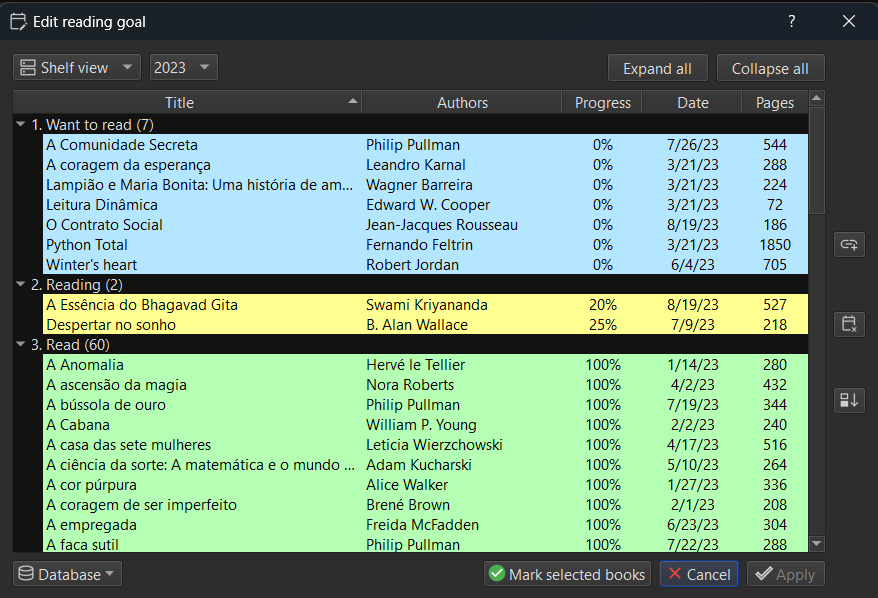

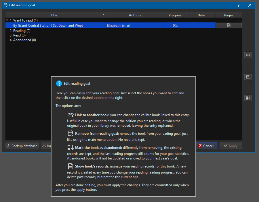

  3. Edit reading goal:
    • Here you can see all the books in your current reading goal
    • Books are automatically organized in shelves (Want to read, Reading and Read), based on their reading progress
    • Besides overseeing your reading goal, you can edit it:
      • Link to another book: you can change the calibre book linked to this entry. Useful in case you want to change the edition you are reading, or when the original book in your library was removed, leaving the entry orphaned
      • Remove from reading goal: remove the book from you reading goal, just like using the main menu option. No record is kept.
      • Mark the book as abandoned: differently from removing, the existing records are kept, and the last reading progress still counts for your goal statistics. Abandoned books will not be updated or moved to your next year's goal.

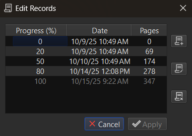

      • Show book's records: manage your reading records for this book. A new record is created every time you change your reading progress. You can delete past records, but not the current one.
        • Delete this record: if the book has more than one reading record, you will see this button for past records.
    • Changes will be committed only when you hit Apply

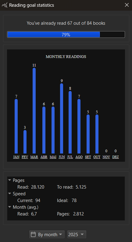

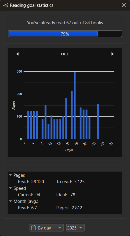

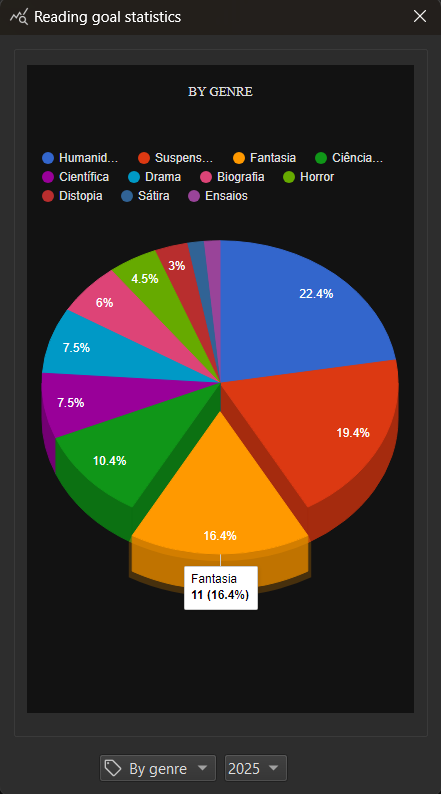

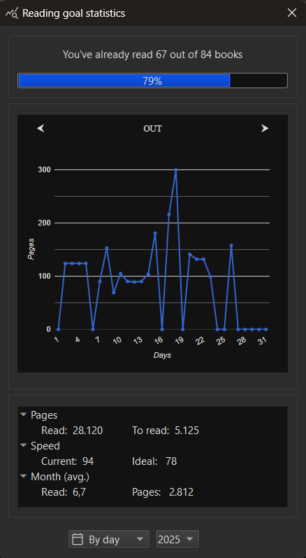

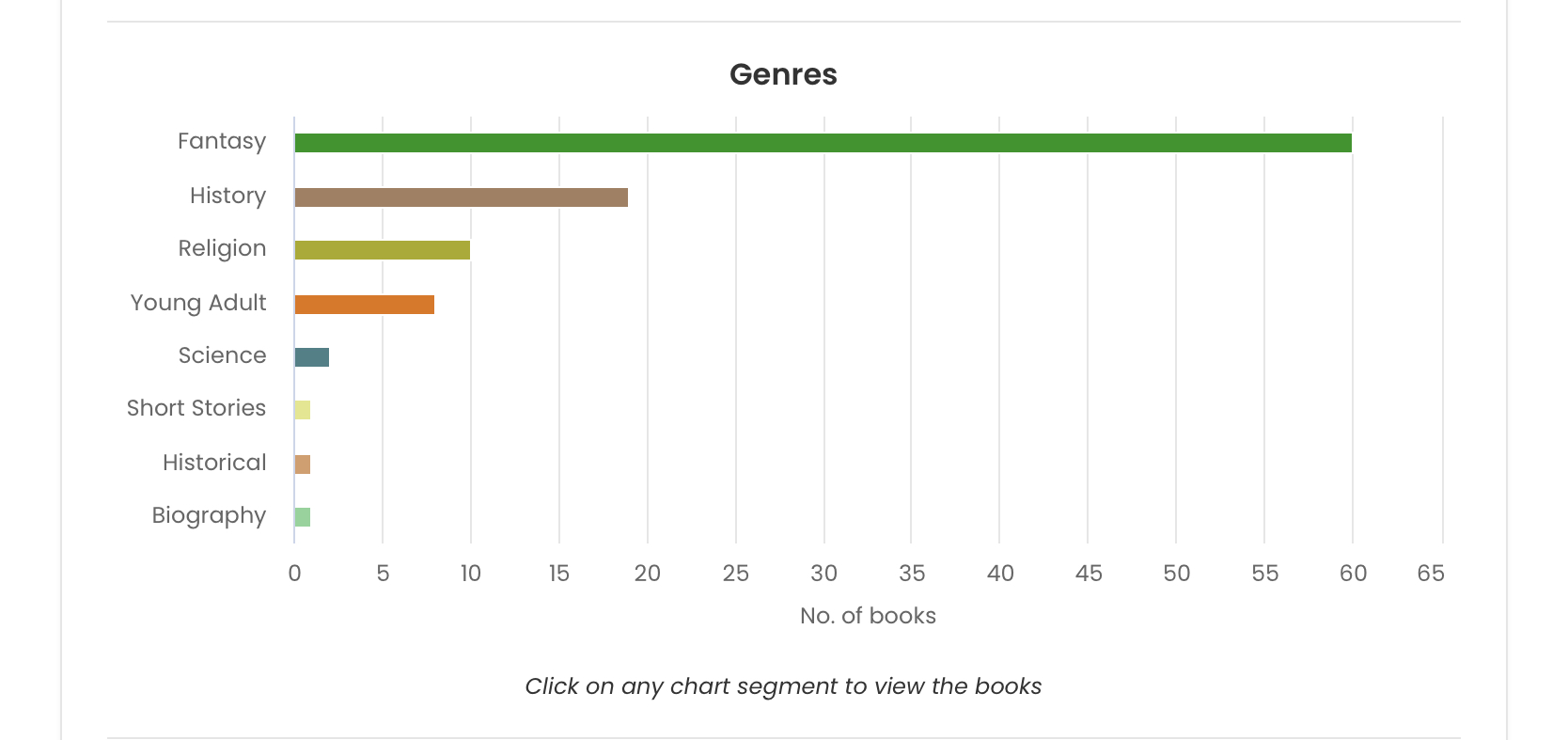

  4. Statistics:
    • Here you have multiple graphics and statistics:
      • Readings by month
      • Readings by day
      • Readings by genre (top 12)
      • Annual readings
    • You can also see the statistics for previous years, if they are present

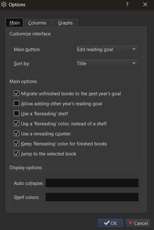

Plugin options:

  5. Main options:
    • Migrate unfinished books to the next year's goal: if you check this option, when a new year starts, all books on your Want to read and Reading shelves will be moved to your current year reading goal.
      • Your reading progress for the last year will not be taken into account when calculating your current year statistics
      • Abandoned books will not be moved
    • Allow adding other year's reading goal: if you check this option, when adding books to your goal, you will be prompted to confirm the year (automatically fetched from selected books). Note that every book must have the same year to be added in batch.
    • Use 'Rereading' shelf: If you check this option, books that you already read before, will be added to a Rereading shelf.
    • Use a 'Rereading' color, instead of a shelf: Check this option to use a different color for rereadings.
    • Use a rereading counter: Check this option to add a counter for how many times you've reread the book.
    • Keep 'Rereading' color for finished books: If you check this option, it will retain the line color for books migrating from the 'Rereading' shelf to the 'Read' shelf.
    • Jump to the selected book: If you check this option, when opening the 'Edit reading goal' dialog, it will jump to the selected book in your calibre library.
  6. Display options:
    • Auto collapse: List the shelves you want to be collapsed when opening the 'Edit reading goal' dialog. Use a comma separated list with the shelves numbers. Example: 1, 3, 5.
    • Shelf colors: Set the color for each shelf on the 'Edit reading goal' dialog. Use a python dictionary with shelf number and RGB value. Example: {1: (180, 230, 255), 3: (250, 190, 80)}.
ID:	218880   Click image for larger version
Name:	Records editor.png
ID:	218885   Click image for larger version
ID:	218886   Click image for larger version
Name:	Daily - Line.png
ID:	218887   Click image for larger version
Name:	Daily - Bars.png
ID:	218888   Click image for larger version
Name:	Genres - Pie chart.png
ID:	218889   Click image for larger version
Name:	Config - Main.png
ID:	218890   Click image for larger version
Name:	Config - Columns.png
ID:	218891   Click image for larger version
Name:	Config - Graphs.png

I've just now thought of this: the Highlights in the Annotations browser have a timestamp and possibly a coded "position". I'm sure this would mean a lot more work in your plugin and would be rarely used by most people, but if it were able to pull the last highlight position (actually the nearest one towards the end of the book), this would make a very interesting reading progress pointer for me. :P
(also, not sure if it would be feasible to somehow translate that highlight position into some #percentage/progress column). Just a thought...
Name:	MWSnap 2023-08-24, 10_49_41.png

Originally Posted by thiago.eec View Post
Besides, the reading progress (%) is also needed for the sync plugins (like Goodread Sync and Skoob Sync).
For my syncing with GoodRead Sync I don’t need reading progress, did I miss something?
EDIT: Actually, using a tags column makes no sense. For sorting to work, it would have to be a single value column.
Not entirely right. My history books with the different eras and subdivisions are grouped quite well by this.
Bonus would be a chart similar to StoryGraph.
Wiggo is offline   Reply With Quote
