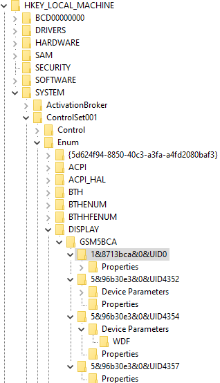

I am a bit worried about the idea of using the FriendlyName key combined with the serial number, because at least in my case, that key didn't exist for me, and as far as I know it's not something that's exposed outside of the registry (maybe an extension like Powertoys would have an option to set this). So if this is the proposed fix, it'll (probably) work for me because I can do that, but your other users may not be as comfortable with the idea of ticking their registry.
Maybe, if you're able to access other keys, the "Driver" key may be an option, as that inherently has the unique number after the slash:
Left: 	{4d36e96e-e325-11ce-bfc1-08002be10318}\0003
Right: 	{4d36e96e-e325-11ce-bfc1-08002be10318}\0004
The number in braces matches the ClassGUID; maybe the number after the slash represents the graphic card's port? Also, the folder the keys themselves are in are unique (see attachment). The folders with "Device Parameters" subfolders are the current monitors while the ones without are old/unused.
Name:	Screenshot 2023-08-24 151725.png

I thought Windows 10/11 was able to set a Friendly Name for any device using regedit. If not, then this solution will not work. I did a search on giving a friendly name to your display monitor on windows and it comes up with many tutorials, so I thought that would be doable.
I understand this may not be a solution for everyone, but it only is needed with two identical monitors when both have exactly the same serial numbers in the edid block. This should be quite rare as edid serial numbers should always be unique, but in your case are not.
This would be a stopgap solution for power users until Qt figures something out.

Yeah, you can in Regedit. My point was that going into the registry is a big ask for the end user, so my point was that it's not an ideal fix, even if it's the best you can do on your end for now.

I was limited by what data the qt windows plugin had already gathered from the registry and the edid block. The device Friendly name was collected but not used and it was available in the routine in question and so it was that or force a complete reworking.
Let's please give this a try, as using regedit need only be done once and should stick across restarts. Hopefully, it will make this entire problem go away.
If Qt does not provide a better fix in their LTS Qt 6.5.X, I will look into adding a more extensive solution that does not require a registry change.
