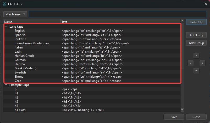

Hi!
As per the earlier suggestion on another thread, I'm giving clips a little try.
I had in mind to create a group for my lang tags, and another group for other various clips.
I noticed that clips that are nested under a group don't appear in the Clips bars or in the clips menus (under the Insert menu), only in the clips view, making them harder to fetch and occupying more interface space overall (if displaying the Clips view).
Is that an intended behavior? If so, does that mean that to make sure I see all my clips in the menus, I need to ungroup them?

I guess I maybe not have been 100% clear, my apologies!
I have created groups of Clips, as seen here:
But these clips are not displayed in the toolbars (I deleted the "help" clip, which causes in turn the sub-menu to not even display):
They do, however, show up if they are not placed inside a group, or in the ClipsWindow

Yes, I noticed this too while trying to teach you about the various ways to use Clips.
Since I always use the lower-left dock version of Clips... I never really messed with the menu/toolbar versions!
I think what StephV is trying to say is:
If the Clips are in a Group, they don't appear (correctly) in the menu/toolbar.
For example, if you press:
  • Tools > Clip Editor
and you have:
  • Italics
  • Bold
  • Smallcaps
  • Languages
    • English
    • French
    • German

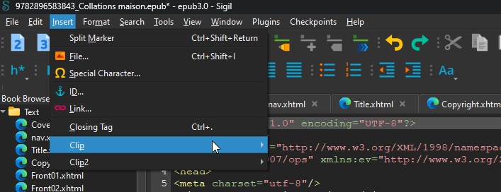

all you will see in:
  • Insert > Clips
is:
  • Italics
  • Bold
  • Smallcaps
and all you will see in the Clip Toolbar is:
  • Italics
  • Bold
  • Smallcaps
Looks like Clips that are in Groups are "invisible" to these alternate methods.

As per usual, Tex2002ans is better than me at explaining, without images too! Yep, that's exactly the problem I have.
Clips contained within groups appear to be ignored/hidden from the menu/toolbars
Apologies for the images. With the delays between my responses, the moderator approvals, etc, I did not realize the links wouldn't work, as I wanted to use the Insert Image function rather than the attachment, but I'll take note for the future. I'm reattaching the images to this post for convenience.
So I have my group:

But an empty menu/toolbar:

Yes, Toolbar buttons are for *individual* clips. They do not cascade their own submenus. You can use the arrow keys in the ClipEditor to easily move them into and out of folders. And the ClipsWindow (docked) is the way to handle larger less frequently used clips that require organization. The Toolbar buttons are meant for very frequently used individual clips, not clip groups.
As far as I know, Sigil has always worked that way.
