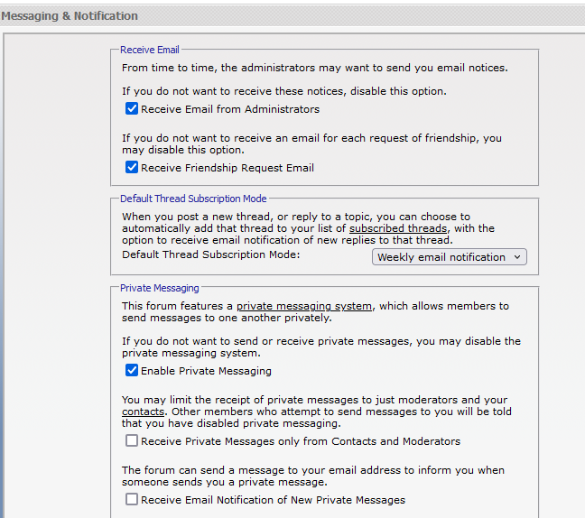

Private message access:
You will need to have PMs enabled for me to send you the link. To see if you have PMs enabled, click on the User CP button. Then click on Edit Options and then scroll down to Messaging & Notfications. If you do not see a checkmark on Enable Private Messaging, please post in the Requests to enable Private Messages thread to request that they be enabled.
Responding to a PM: Can I send a firmware request in a private message?
Requests sent by PM are not the preferred method and are a pain to keep track of. Requests sent by visitor message are even more of a pain. Please do not use them.
