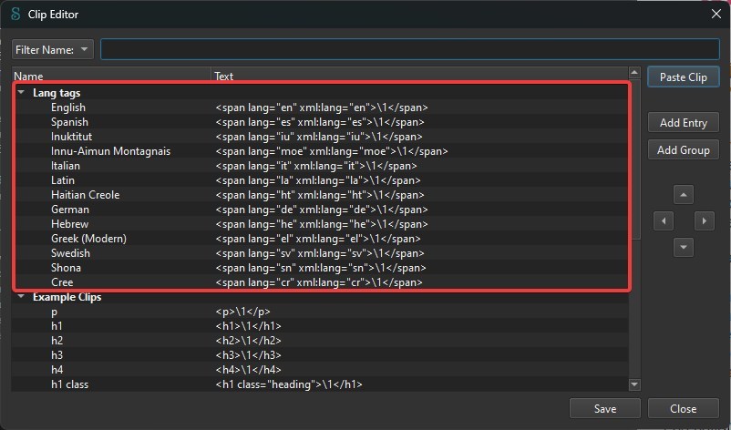

I guess I maybe not have been 100% clear, my apologies!
I have created groups of Clips, as seen here:
But these clips are not displayed in the toolbars (I deleted the "help" clip, which causes in turn the sub-menu to not even display):
They do, however, show up if they are not placed inside a group, or in the ClipsWindow

So I have my group:
But an empty menu/toolbar:
I did make a first test group without deleting the help clip and the help clip was still the only one to be displayed in the menu/toolbars.

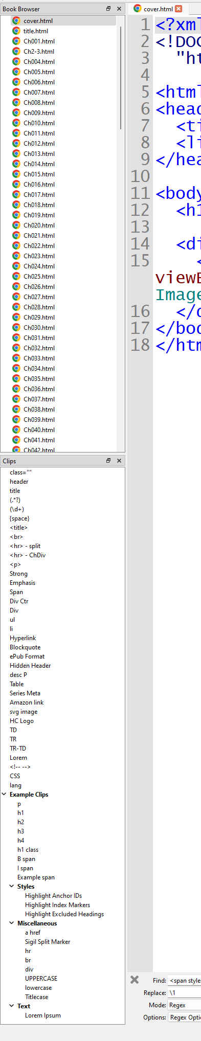

Originally Posted by StephV View Post
In any case for now, I will ungroup the most used ones and leave the least used ones in the group. That does however mean that whenever I want to quickly use one of the grouped ones, I will have to pop out the Clips Window. I know most people use two monitors at the very least but right now I'm limited to just one, so you may understand my concerns with screen space and all. (I really need to put in a request for a second monitor at my job for my WFH setup... Ugh...)
I only have 1 monitor now...although my wife complains that it is bigger than her tv...
I dock the Clips window so it shows up either below the book browser on the left side, or as a tab behind my Table of Contents and Preview windows on the right side. I flip-flop depending on how I'm feeling on any given day!!
Name:	Screenshot 2023-08-23 152618.png
ID:	203311   Click image for larger version
Name:	Screenshot 2023-08-23 152258.png
