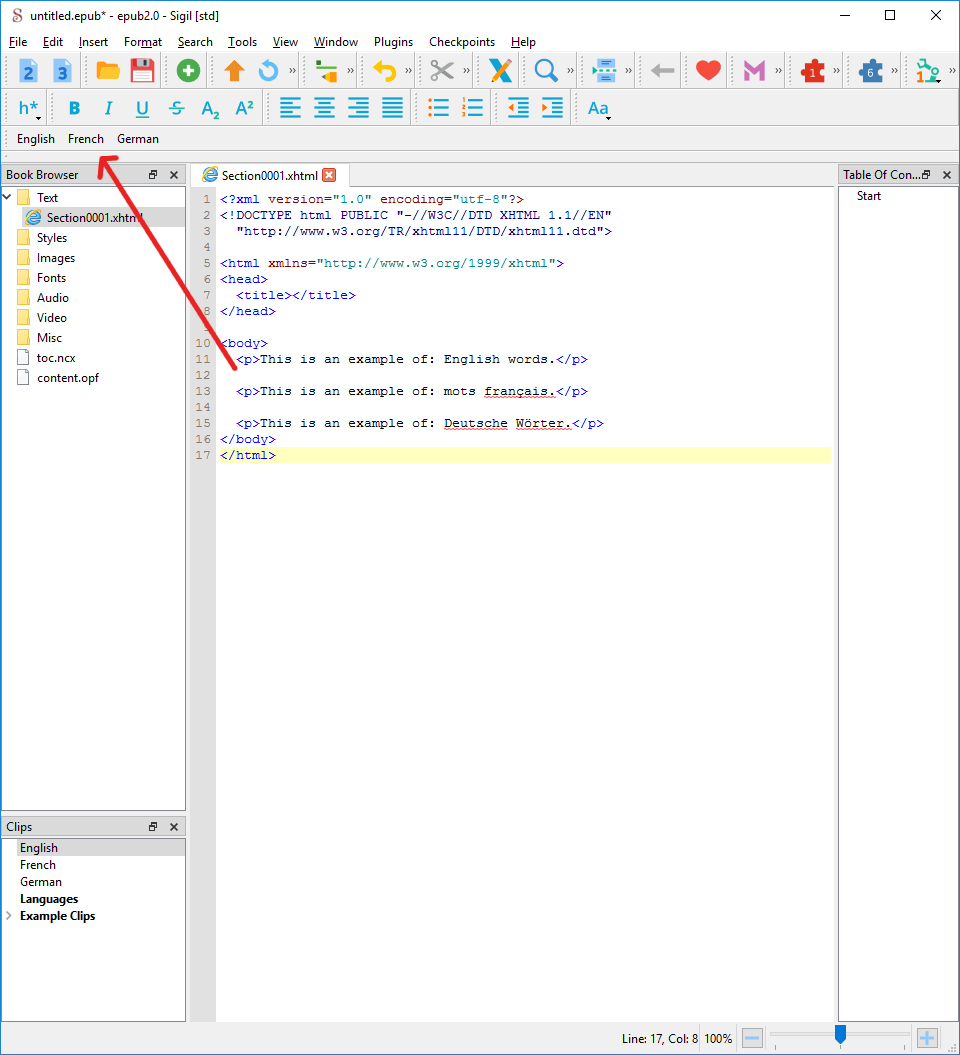

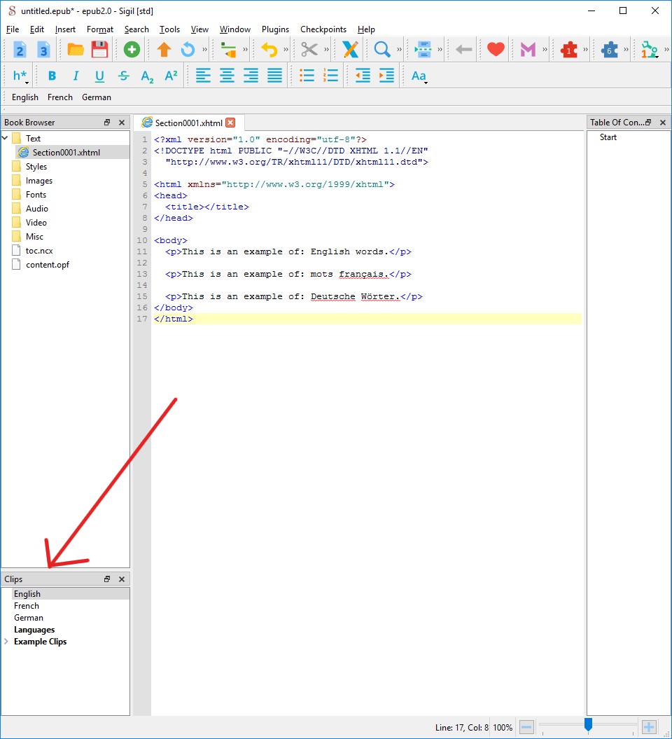

Just use Sigil's Clips feature. That is exactly what it was meant to do. Make a clip for each snippet you commonly use.
Yep! Exactly!
Using the Clips Editor
You can add/edit all your clips by pressing:
  • Tools > Clips Editor (Ctrl+Alt+C)
Then you can create multiple Clips to help mark up languages like:
Text: <span class="english" lang="en" xml:lang="en">\1</span>
Text: <span class="french" lang="fr" xml:lang="fr">\1</span>
Text: <span class="german" lang="de" xml:lang="de">\1</span>
Side Note: See the \1? In Clips, that means Sigil will insert "whatever you have highlighted" in that spot!
Side Note #2: If you constantly find yourself copying/pasting/inserting large "templates" of code, Clips are great for that too!
Setting Up the Clips Window/Toolbar
Now, if you press:
  • View > Clips
you can show an easy-to-click window of all your Clips. For example, I set mine up in Sigil's lower-left corner:
Or, if you prefer toolbars, you can:
  • View > Toolbars > Clips Bar
  • View > Toolbars > Clips Bar2
to enable extra toolbars up top:

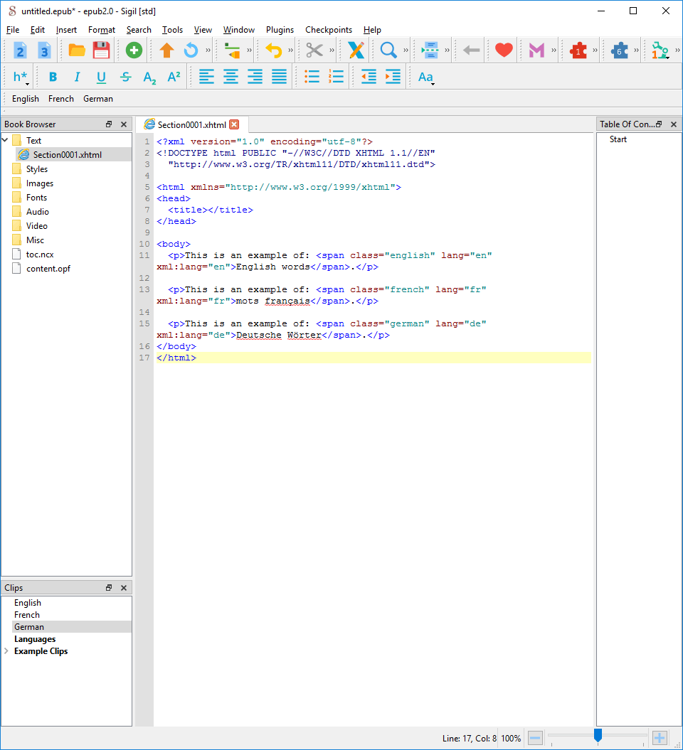

Actually Using The Clips!
Now, if you had text like:
<p>This is an example of English.</p>
<p>This is an example of François.</p>
<p>This is an example of Deutsch.</p>
you can:
  • Highlight your word/sentence/text/code.
  • Click on a Clip.
and Sigil will insert that Clip code (around your highlighted text):
<p>This is an example of <span class="english" lang="en" xml:lang="en">English</span>.</p>
<p>This is an example of <span class="french" lang="fr" xml:lang="fr">François</span>.</p>
<p>This is an example of <span class="german" lang="de" xml:lang="de">Deutsch</span>.</p>
