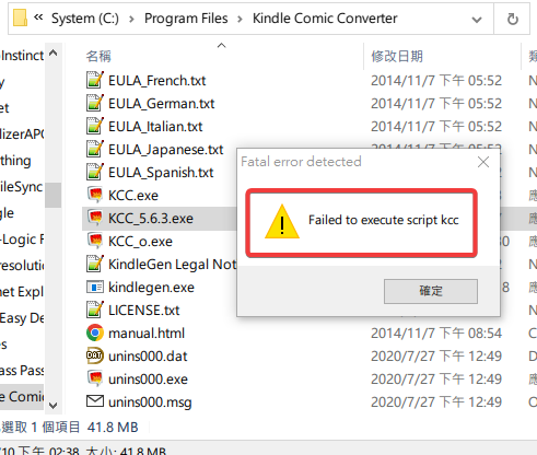

Originally Posted by axu2 View Post
KCC v5.6.3 is now in pre-release: https://github.com/ciromattia/kcc/releases
How can I fix this problem?
Attachment 203092
Please open an issue on GitHub. I got that problem too. Looks like a GitHub Action issue.

Originally Posted by lohtse View Post
you got a link to it as I could not find it and I have the same issue.
You can still use the older v5.6.2 build for Windows. v5.6.3 was mostly fixing Mac support.
Went ahead and opened an issue: https://github.com/ciromattia/kcc/issues/578
