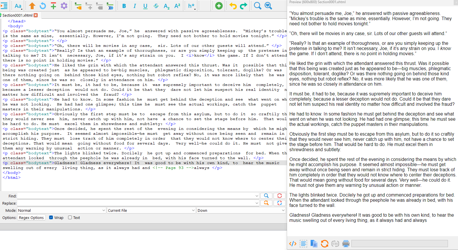

I have been converting scanned texts to epubs and it occurred to me that if I put the original page numbers in a html comment, it would make finding the source of the text easier. There is one minor problem. If the comment appears in the middle of a paragraph and I click after the comment, it syncs the preview window to the top of the file. I have attached a small file to show the problem. Rename to .html and load the file into sigil and click on the word 'always' at the end of the file.

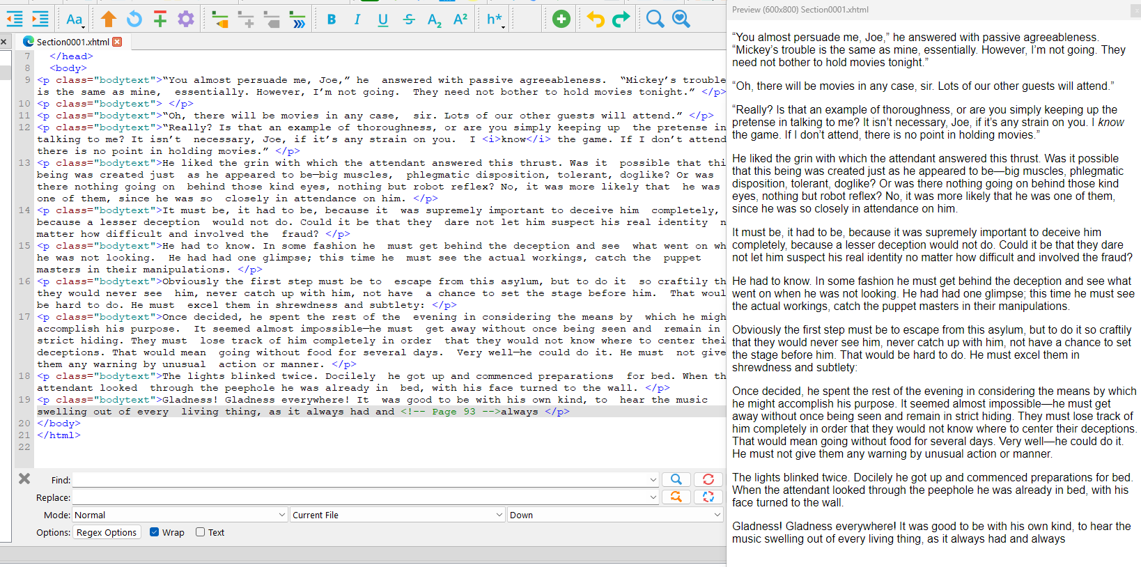

I can't duplicate your results here. If I open the preview window and click on the 'always' after the comment, that line is highlighted in CodeView. If I click on the text before the comment, CodeView highlights the line that starts the paragraph. See attached images.
ID:	203068   Click image for larger version
