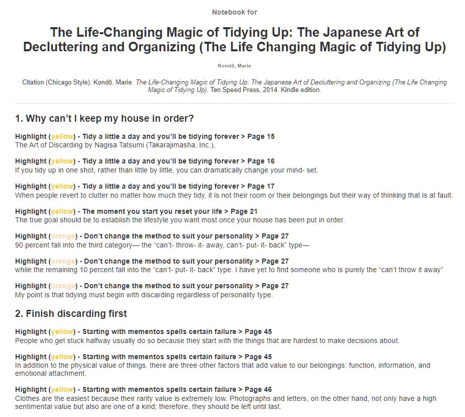

Kindle has two ways, from app and ereaders, to export highlights and the formats are different. The one from ereaders exports a spreadsheet and a pdf file. The one from the app exports a html file. All of them are fantastic. I attached the screenshot of a html file here. Isn't it nice? I wish Kobo will come up with something similar.
