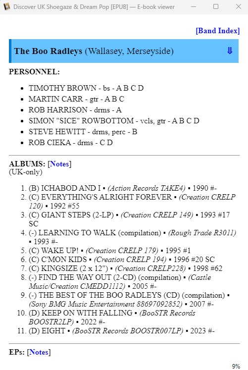

Thanks @Aleron Ives. I've now replaced all the tables with lists for the discographies / personnel sections. Formatting some sections in italics and adding a UTF-8 character between each section seems like a reasonable compromise.
Many thanks!
Ivor

Old 09-16-2023, 05:42 AM   #13
Aleron Ives
Posts: 1,937
Karma: 17671736
Join Date: Sep 2022
Kudos for sticking with EPUB and adjusting your formatting techniques for reflowable text. Your users with small screens will be grateful that they don't have to zoom and pan around a PDF.
