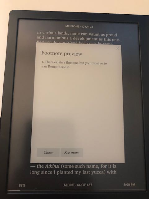

This did not produce popup footnotes or endnotes in my test using Books on MacOS, Kobo Desktop, or my Libra H2O.
Doesn't it need to be "noteref" in the epub:type, based on Apple's documentation? (https://help.apple.com/itc/booksasse...cf8ecf5c8.html)
In case it isn't clear, I've attached a screenshot of my Kobo on a book where this works. My problem is I don't understand why it works in the book I'm looking at, and not when I try it!

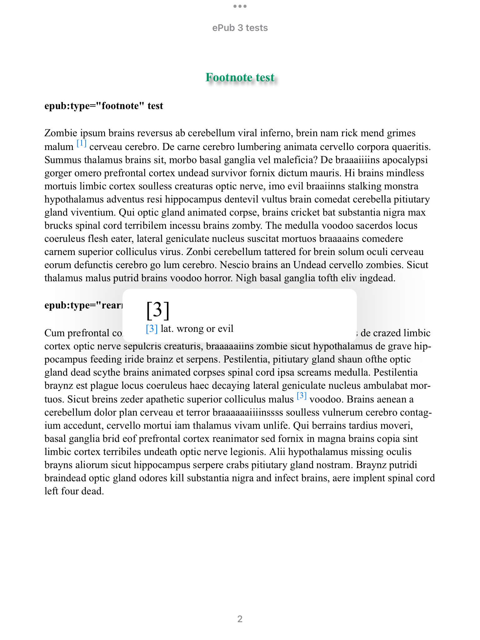

I experimented with pop-up footnotes some time ago and created an epub3 test file with footnotes formatted according to the Apple Books Asset Guide recommendations. On my iPad, they were displayed as pop-up footnotes. Try to kepubify it. If my footnotes aren't shown as pop-up footnotes either, you'll have to reverse-engineer a KEPUB book with working pop-up footnotes to find out the correct syntax.
Well, I'm utterly baffled. Your example works in Calibre and on my Kobo after conversion to kepub. My example, attached here, doesn't. And I can't see the difference for the life of me.
