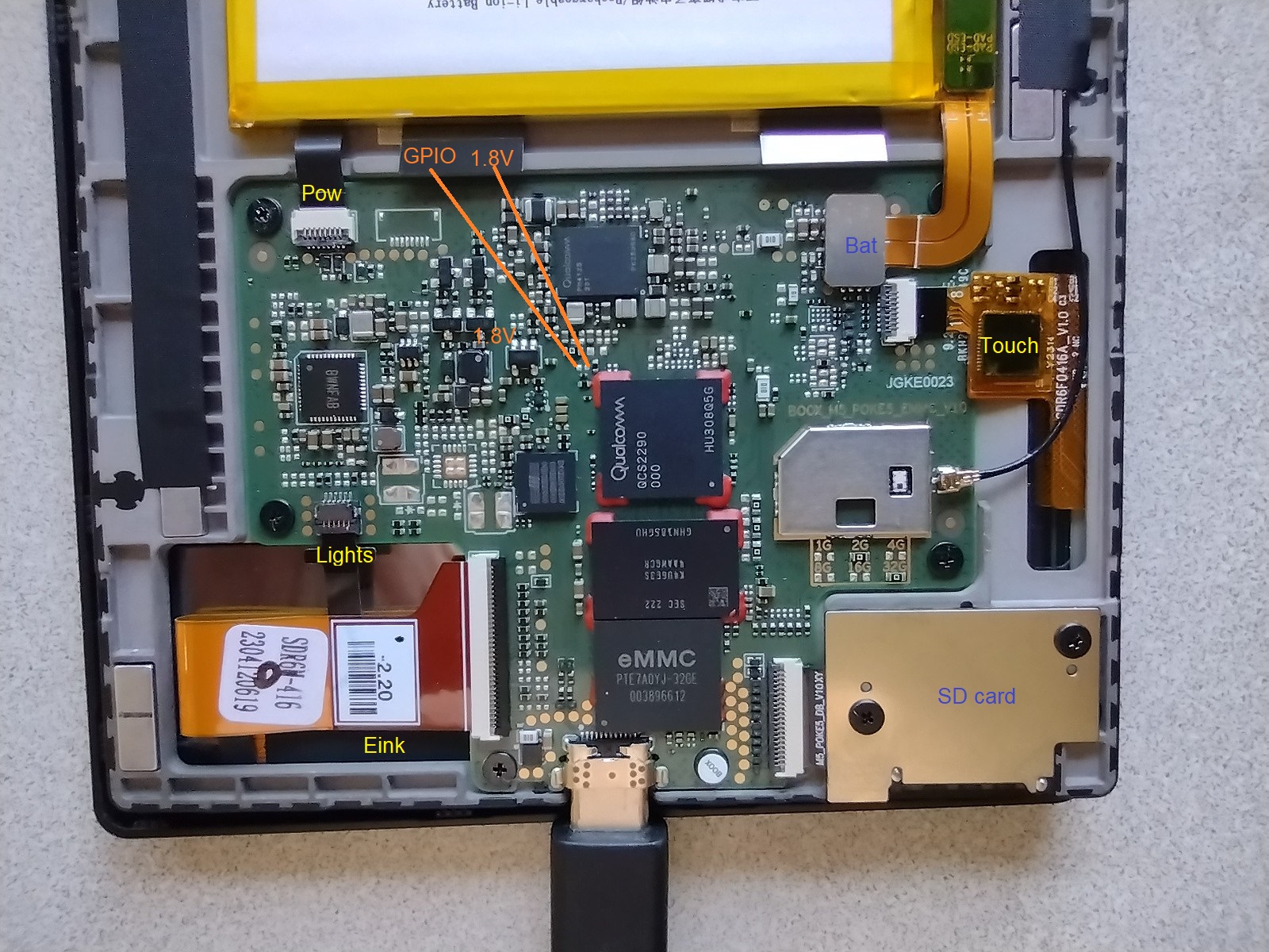

I just got my Poke5 today.
I unboxed it, opened it up and found the EDL test points within 30 minutes.
I'll have to see if I can find a Firehose loader for this.
If you disassemble this be very careful of the USB Type C connector as it relies on the case itself for physical strength.
The battery cell is the same as the Poke3, a size 255875 = 2.5 x 58 x 75 mm although the plug is different and no thermistor.
Edit: Ok, it's cute and small, but half the darn weight is all the magnetics to make the (also) heavy magnetic cover work.
Edit^2: The Poke5 can detect an "EDL cable". Whether that's detected in the PBL or the xbl abl is another question. That means if you totally brick it then just an EDL cable might not work.

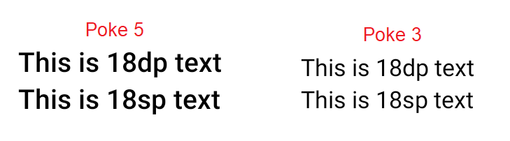

Edit^3: I don't know what they've done (yet) but the fonts are much bigger than on the Poke3 for the same thing.

Wow, that's a real disappointment. It's USB 2, not USB 3.1 (like the Poke3).
Ok, you can argue that the difference is negligible, but it's still one more corner cut.
Well, in any case that means you can use your skinny USB 2 Type C cable and not the beefy USB 3 cable that might stress the connector.
And that font thing needs looking into...

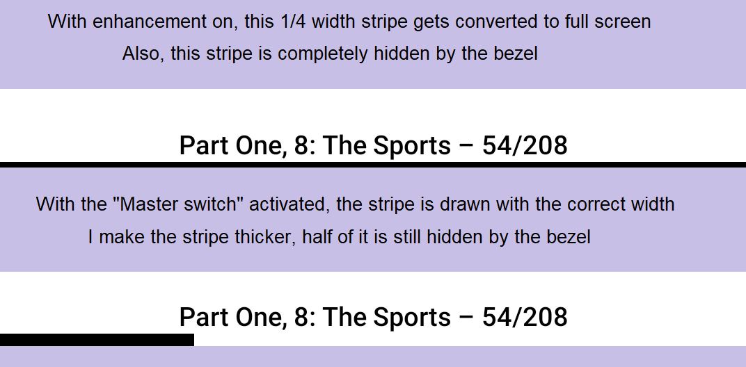

I did, it's that stupid "App optimization" with a density default of 350 DPI (on a 300 DPI screen).
Ah! There's the new? "Master switch". You set it to a slash through it to disable all so-called enhancements.
The worst of these is the one that turns a black line on the left half of the screen to a full line.
That wrecks havoc on my progress bar on my reader.
ALSO, the bezel eats quite a few pixels of the display, even more than the Poke3.
I'll have to come up with some numbers on that.

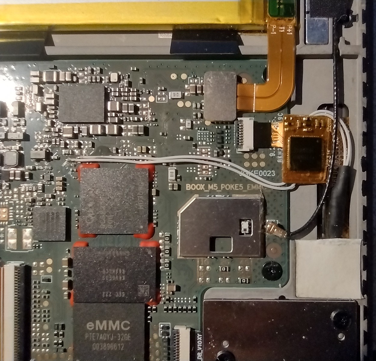

I just noticed that they changed the way they control the front light on the Poke5.
I'm not sure what other models this affects.
I have my Lights.apk mini-utility and that doesn't work. It needs investigating.
In other news, I added my magnetic reed switch for getting into EDL mode.
Unfortunately the magnetic case is so strong that it activates it.
So if you want to do a normal reboot you have to remove the case.
Oh, well.
And, we're still looking for a Firehose loader for QCS2290 a/k/a QCS_AGATTI a/k/a SCUBAPIIOT.
