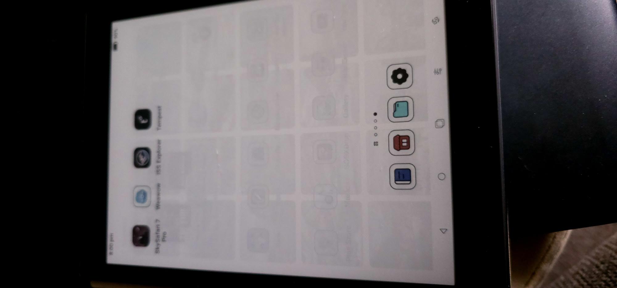

After only a day Ghosting on Tab Mini C
Have only had my Mini Tab C for not even 24 hours, the next day turned it on the next day and on balanced mode which I use, Ghosting

Really bad ghosting can occur if there is incorrect sensing of the ambient temperature.
Does 6-7 normal (not big black-white-black) updates clear the ghosting?
In the past (and maybe today?) there was only battery temperature sensing.
Try using my UsbMode.apk (in my sig) and see if the temperature reported agrees.

Seems Ghosting disappears when using it, something like 10 mins or 1/2 no Ghosting, only when first Turning on. I the afternoon today was warmer so ko Ghosting, turned it on this morning Ghosting then overtime Ghosting disappeared
