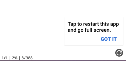

In certain applications such as KoReader, every time I rotate my device, I get the notification:
Tap to restart this app and go full screen.
Interestingly, the app is already in full screen mode. Does anyone have any know how to eliminate this popup? It's quite annoying.
Maybe.
In AndroidManifest.xml they have:
android:resizeableActivity="false"
Why do they do that? Try changing that to true.

That solved it! Thanks again Renate!
Maybe it would be easier to make a resizeableActivity.lua patch and place it under 'storage/self/primary/koreader/patches/' instead of recompiling the app everytime there's an update. But this will do for now.
