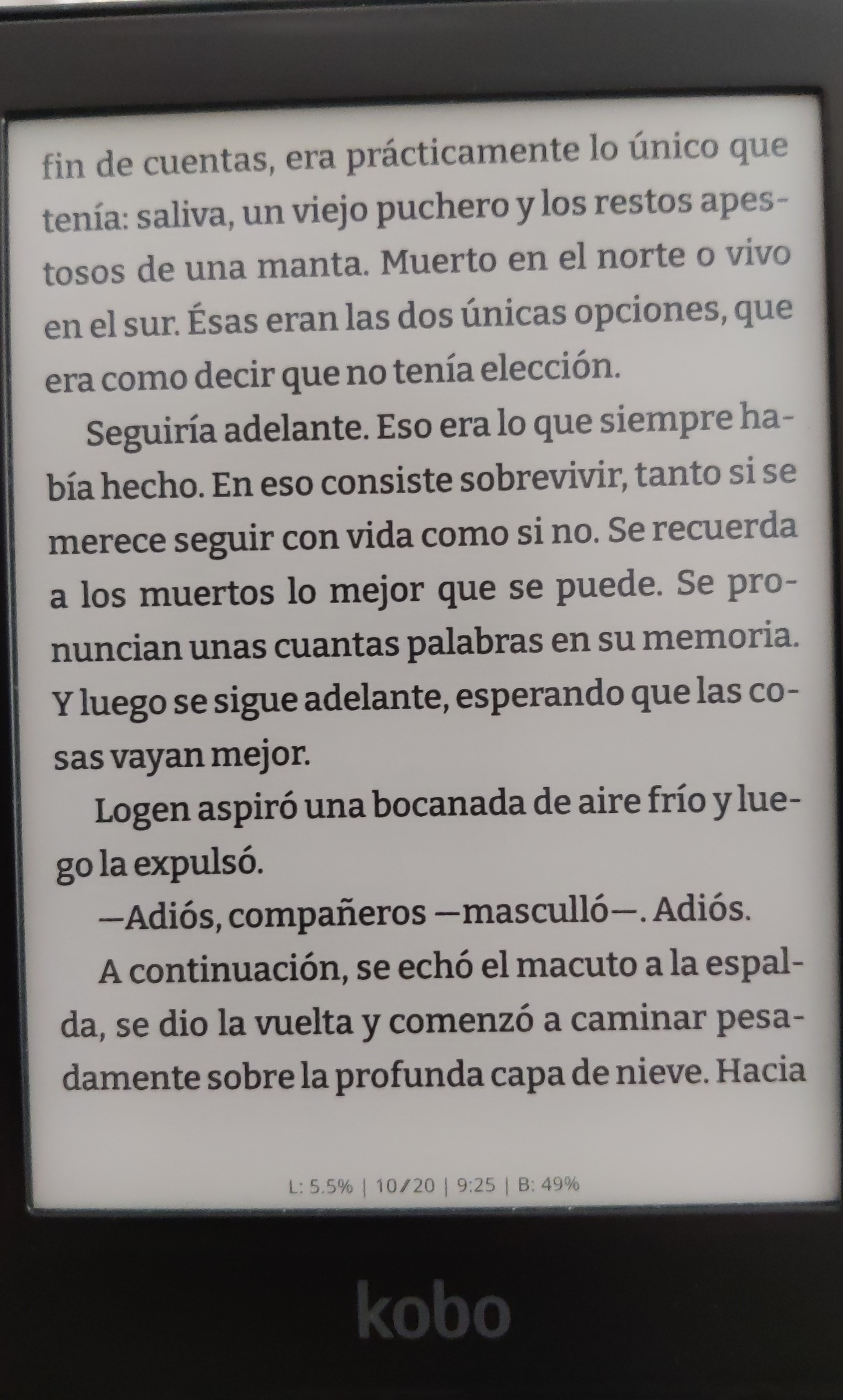

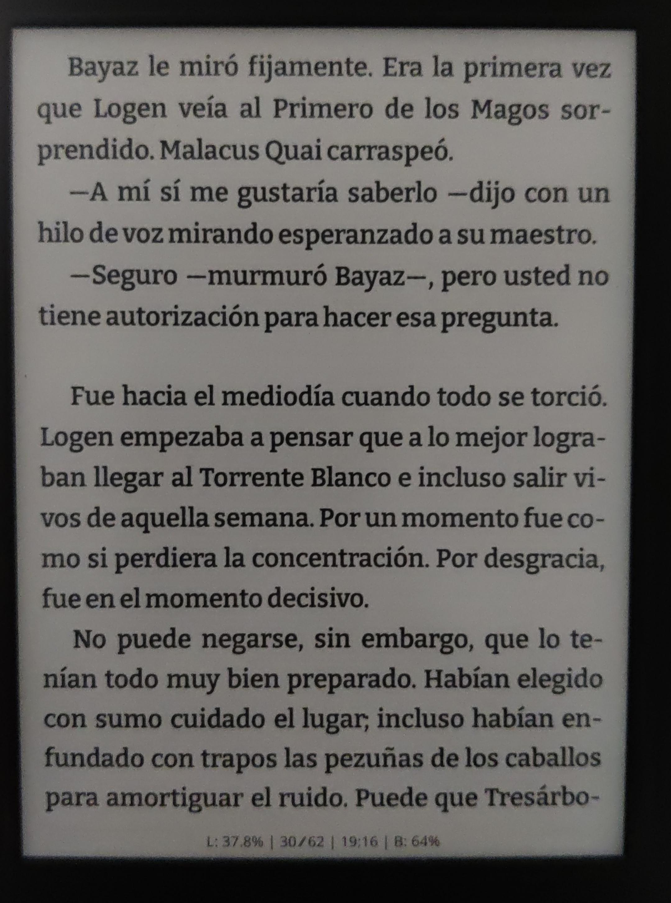

Hello everyone,
First, I apologize for the level of English (Google Translate)
I attach two images where the problem is shown, which is basically that when there is a paragraph break at the end, a line skips to the next page, leaving an empty line on the previous one.
Now there are the values of orphans and widows at 1, I have tried at 0 and the result is the same.
Thank you so much

In addition to (possibly) orphan & widows shenanigans, you happen to have gigantic line-widths *and* rivers between (some? perhaps weird scene breaks?) paragraphs, so the second screen-shot looks correct to me (as in, there's not enough actual space to put another line at the bottom there)?
The padding top/button is modified by me (Calibre), so that it fits exactly with the line. As you can see in the second photo, it does include one more line.
I have modified this padding top/button with other values and the same thing happens, there is simply more space below, but it moves me one line to the other page.
Forgive me for the screenshots that are a bit confusing.

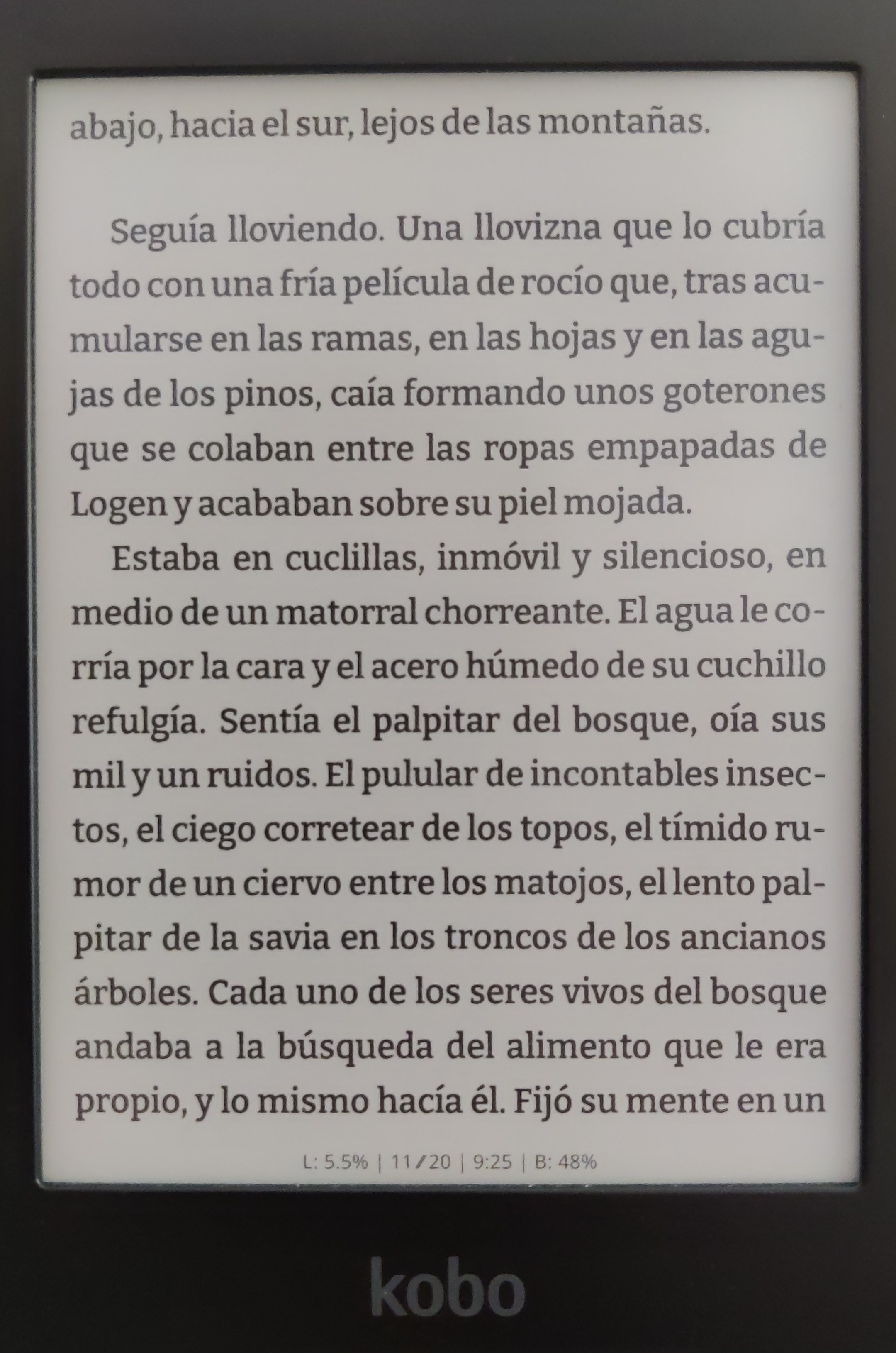

Maybe your empty-line has too large line-width? The one between the paragraphs.

If that were the case, shouldn't it also happen here?
