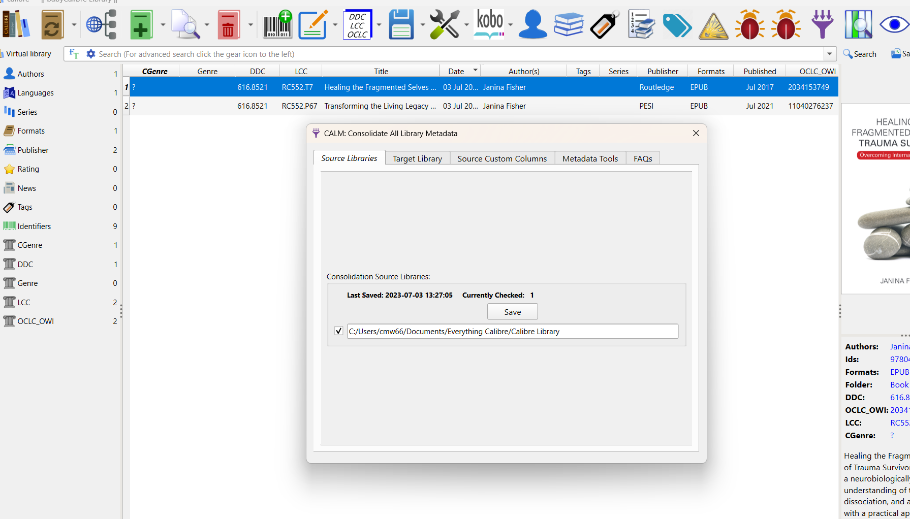

problem re-loading source libraries
On Windows 11 home, Calibre version 6.22
I'm trying to learn to use the CALM plugin and cannot load source libraries properly. This happened before, and the solution to remove CALM and then re-start calibre, add CALM back, and then re-load source libraries worked.
However when I tried this today, the same sequence did not work to all my to see previously unchecked libraries.
What else should be done?
You must read, understand, and follow the CALM Instructions.
See the attached image; the yellow highlights are your answer to your immediate issue.
