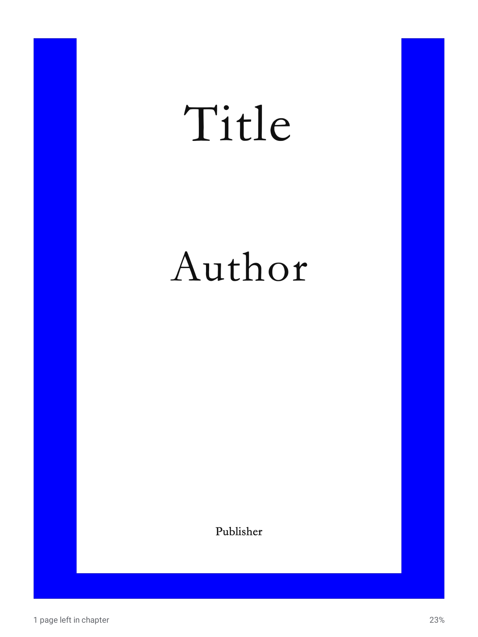

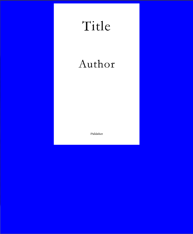

Old 07-02-2023, 11:28 PM   #42
Interrobang
Oracle Pig Keeper
Interrobang , Klaatu Barada Niktu!Interrobang , Klaatu Barada Niktu!Interrobang , Klaatu Barada Niktu!Interrobang , Klaatu Barada Niktu!Interrobang , Klaatu Barada Niktu!Interrobang , Klaatu Barada Niktu!Interrobang , Klaatu Barada Niktu!Interrobang , Klaatu Barada Niktu!Interrobang , Klaatu Barada Niktu!Interrobang , Klaatu Barada Niktu!Interrobang , Klaatu Barada Niktu!
Posts: 26
Karma: 5024
Join Date: Jun 2023
Device: Kindle Fire HD, Samsung Tab
It appears you had a margin for your <body>. I set that to 0 and it appears to work fine...in Sigil...try it on your device.
My original body style had both margin and padding settings, but it didn't seem to make any difference so I took them out.
<body style="margin: 0; padding: 0; background-color:rgb(0,0,255)">
I can certainly put it back in and see what happens with the other changes. BTW I had the background color set to blue just so I could easily see the boundaries of the viewbox. I intend to use black for production.
There does seem to be a bit of a difference in the displayed image between the tablet, Sigil, and ADE. So while Sigil and ADE are good for quick previews, I send it to the device to confirm how it will look to the end user. Or am I supposed to code it so that it looks the same on all three? At this point that seems like a near impossible task.
Interrobang is offline   Reply With Quote
Old 07-02-2023, 11:45 PM   #43
Interrobang
Oracle Pig Keeper
Posts: 26
Karma: 5024
Join Date: Jun 2023
Let us know if that works on your device(s) as well!
Per your suggestion, I changed the code as follows:
  <div style="margin: 0; padding: 0; text-align: center;">
    <svg xmlns="http://www.w3.org/2000/svg" height="100vh" preserveAspectRatio="xMidYMid meet" version="1.1" viewBox="0 0 1275 2100" width="100vw" xmlns:xlink="http://www.w3.org/1999/xlink">
      <title/>
      <image width="1275" height="2100" xlink:href="../Images/Title_Page.png"/>
    </svg>
  </div>
</body>
Sigil displayed it fine; ADE shrank the image to about 60%; and the tablet showed it the same size as the other attempts, with a border along the bottom.
I've attached a couple of screenshots so you can see what I'm seeing.
ID:	202420   Click image for larger version
      <title/>
    </svg>
  </div>
</body>
Take out vw and replace it with % and it will work.
