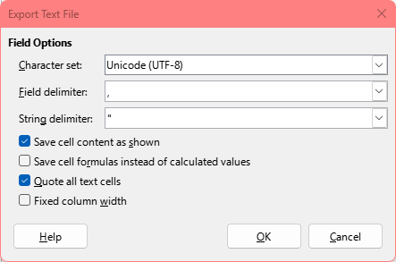

Open a CSV file in a Text Viewer to see what the CSV file really looks like
Originally Posted by jmurphy View Post
In his defense, the screen-shot you included (that had all the tooltips) CLEARLY shows that identifiers should be single-quoted.
In your defense, clearly you are ignorant of CSV file-save options, and do not know how to view a CSV file in a Text Viewer to see the 'real' CSV data.
The double-quotes are for the CSV cells, not the data, as I stated. The double-quotes are inserted by Calc/Excel during the save-as file save option which I referenced. The ToolTips are about what you "see" in Calc/Excel.
Open a CSV file in a Text Viewer to see what the CSV file really looks like without being manipulated by Calc/Excel.
From the .../calibre/plugins/job spy/resources/ example CSV file, as viewed by NotePad. Note the Identifier column. Example cell: ,"'zmyid':'0123456789'",
Calc automatically added the double-quotes per the Save-As > Edit Filter options as shown in the attached image.
I added the single quotes in Calc, as shown in the ToolTips.
"#bookid","added","title ","publisher ","pubdate","comments","tags","identifiers","series","#genre","#myyesno","#myserieslike","#mycomments","#mytaglike"
"25489","2019-01-01","Title1","DaltonST","1960-01-01","These are comments with many commas , and ,, and ,,, and here too ,.","Fiction:Science-Classic,Fiction:Science-Space Opera","'zmyid':'0123456789'","Kzin[1]","Fiction:Science","true","MySeries[1]","These are my comments.","Factual:Autobiography"
"26100","2019-01-01","Title2","DaltonST","1960-01-01","These are comments with no commas but with "double-quotes".","Factual:Biography","'zmyid':'0123456789'","Kzin[0]","Factual:Biography","false","MySeries[2]","These are also my comments","Fiction:Romance"
All of the above has been previously described over the years. Nothing new here.

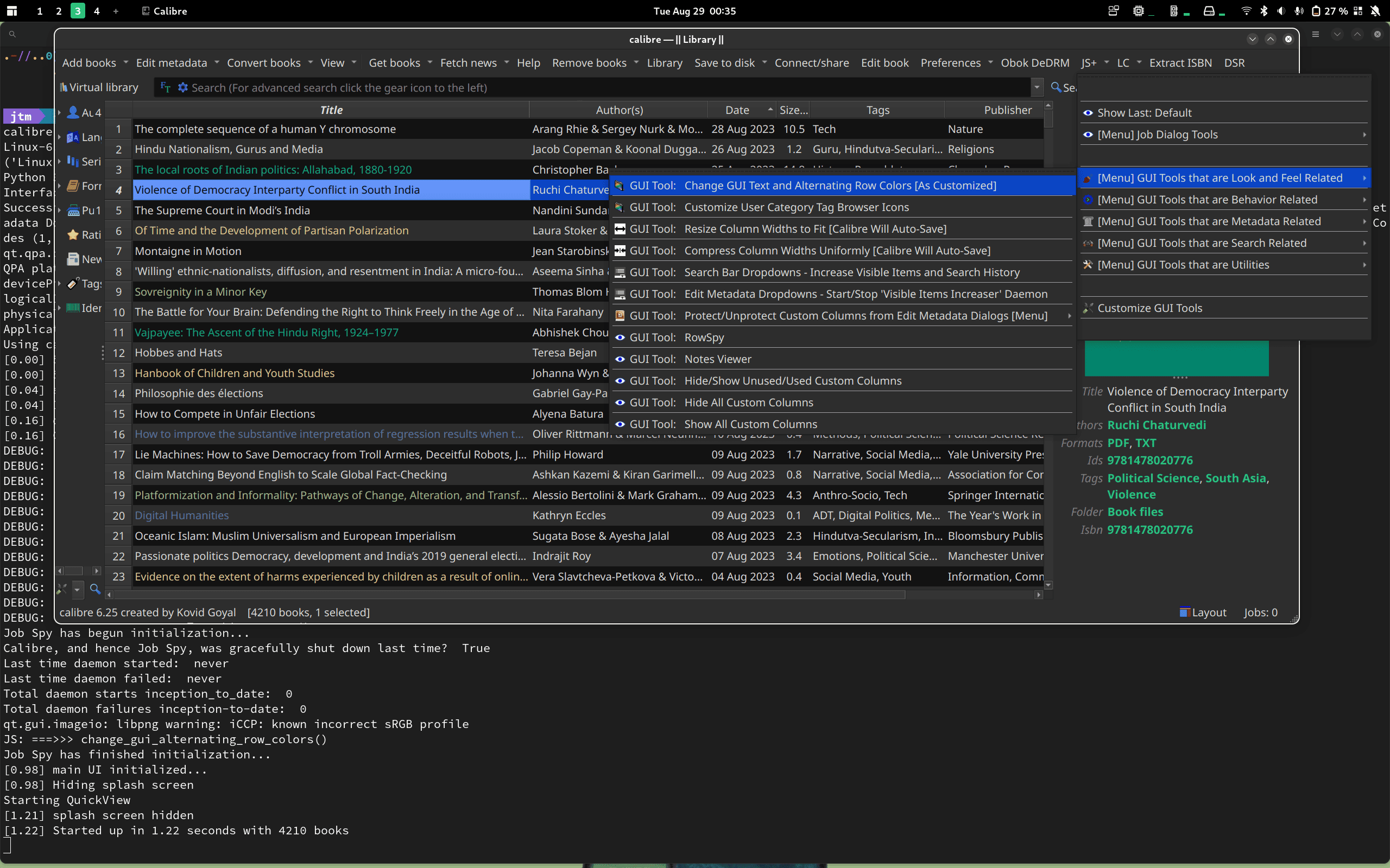

My only longstanding issue is that when I click on the "Change the GUI text and Alternating row colors" nothing happens and the dialog box does not open (see image below). The other panes do open upon click, so the issue pertains to that menu entry only. The Calibre debug logs do not indicate anything problematic (see image).
This issue has been persistent for me for many years (five-six), on many versions of your plugin, both on Linux (Arch) and Windows (10/11) machines.
Do you have an idea on how to fix this?
Thanks for all your work,
Jean-Thomas
