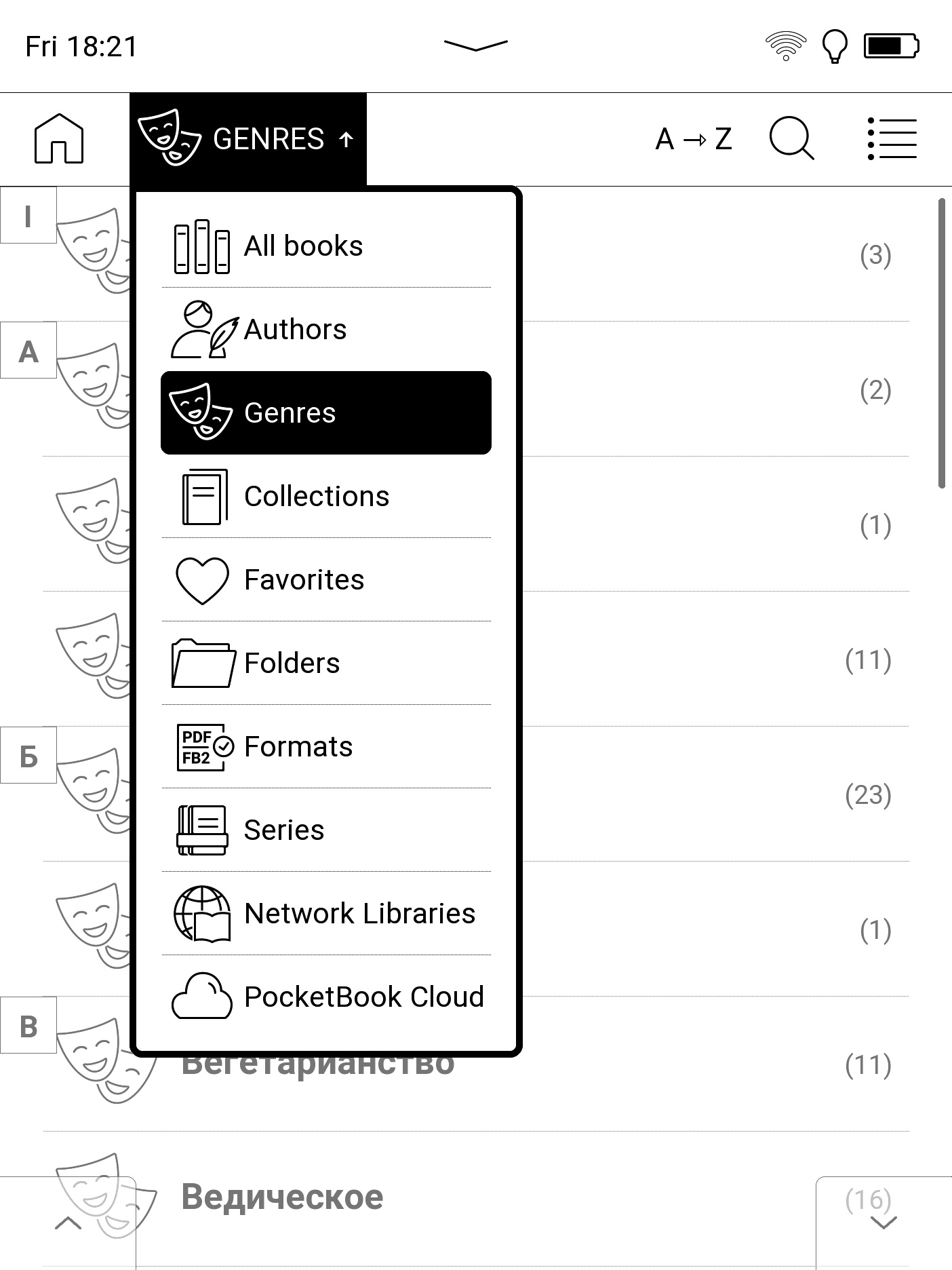

If I assign a specific tag on an ebook in Calibre and send it to my PocketBook 740 it will appear under the corresponding genre section. But if I tag a PDF book the same way it just won't appear under the same section. How can it be achieved?
Does it need a PDF editor to assign a tag so it would appear on the reader in the same section among ebooks with no need to switch to a file type filter every time which is obviously inconvenient?

I added a new PDF in Calibre, assigned a tag, then added to the top panel the Embed metadata icon and click on it while the PDF was selected, nothing happened visually, but I believe the metadata was copied into the PDF. I sent the file to the reader, but unfortunately, the book didn't appear under the genres section.
Maybe PocketBook is designed to display only ebooks under that section? Thank you

Yes, the keyword is there, in the PDFs Properties, but I guess it is not linked with the Genres section in PocketBook, though the authors section works fine for PDFs.

Thank you for your help. I asked support, and apparently, they didn't know it doesn't support pdf sorting by genres, anyway, the first their recommendation was about to reset the device to clear the cache, but it didn't help.
