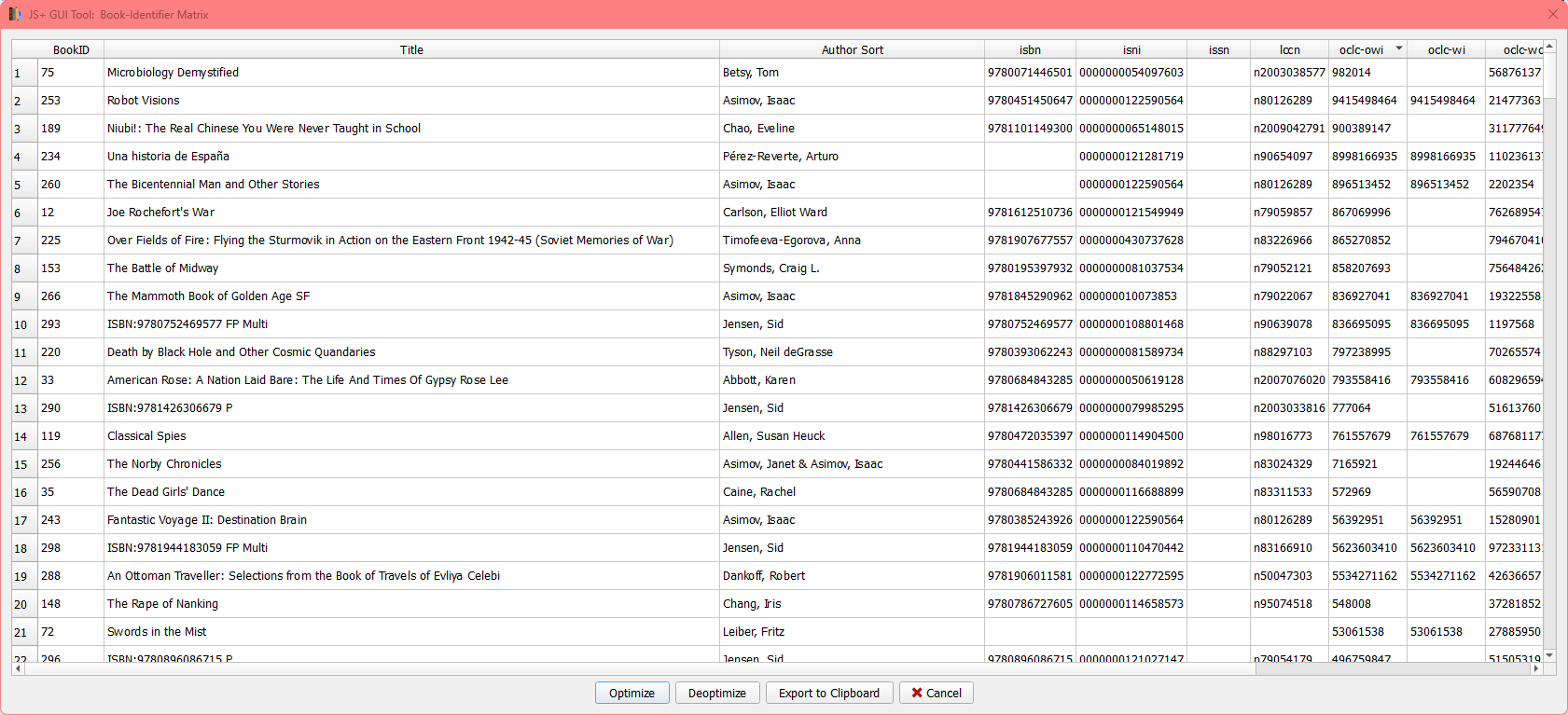

matrix of book:identifiers
See the attached matrix of book:identifiers created by the Job Spy plugin. The JS Tool is under the Metadata sub-menu with the obvious item name.
DaltonST
