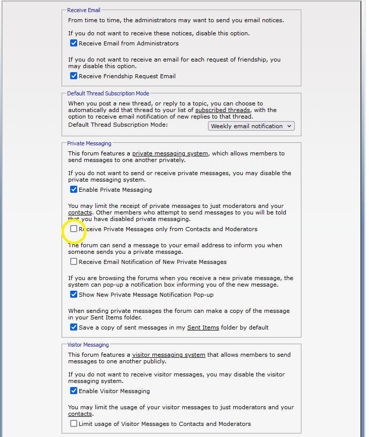

You are going to need to allow me to send you a private message. You currently do not allow that.

I saw your message and checked my edit options but i didnt understand it was "reversed" ( uncheck to receive )
