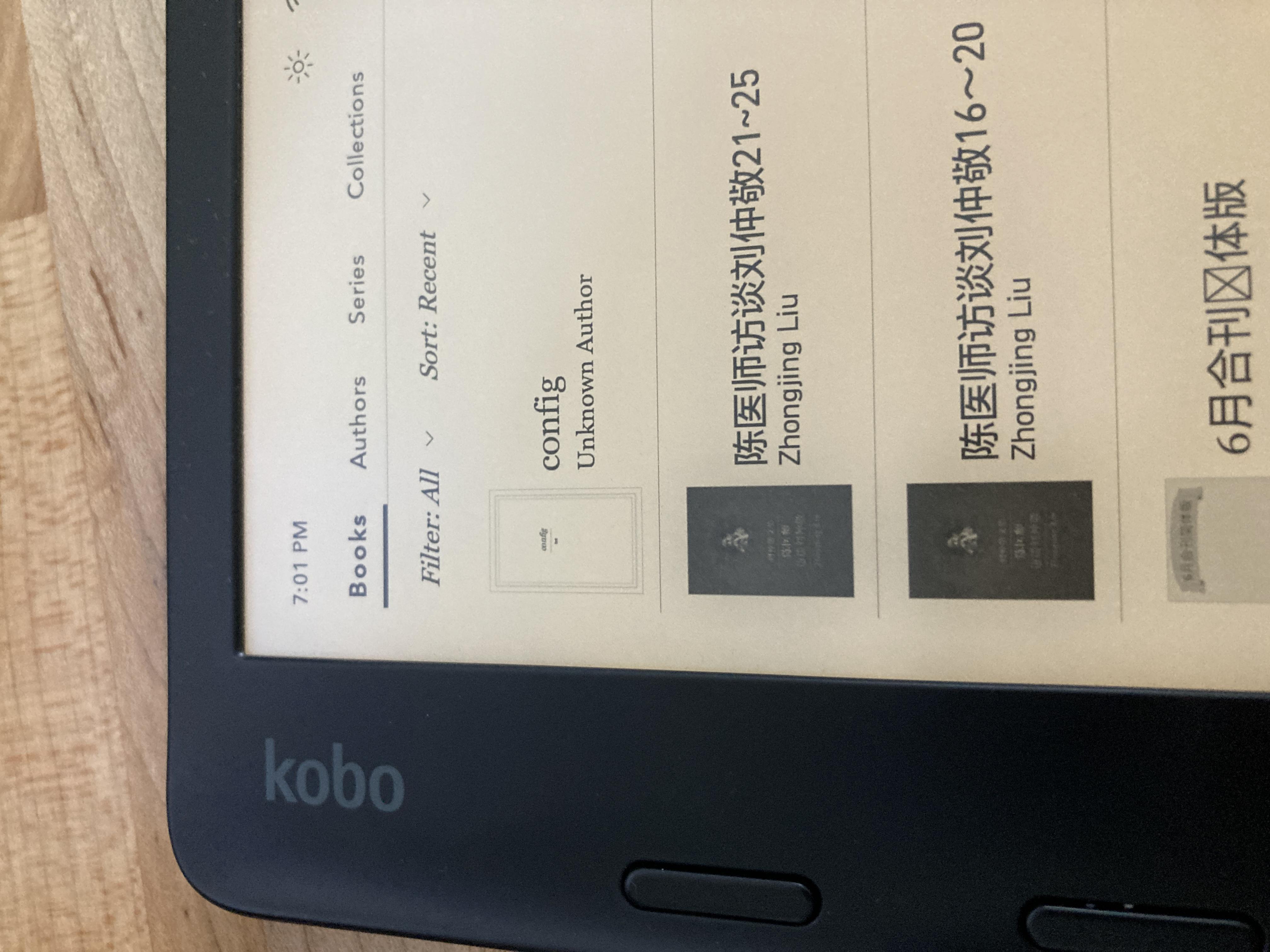

I have a Kobo Libra 2 with 4.35.20400 firmware that couldn't install NickelMenu. There is no extra menu item added to the main menu after Kobo rebooted itself. But when I connect it to my computer, I can see the .adds/nm/doc executable in my Kobo directory. Is there any log that I can get to debug the installation?
h_nara is offline   Reply With Quote

I didn't add the config file before you response as I didn't see a new menu item at step 4 so I stopped there. Then I created a duplicate of 'doc' and renamed it to 'config' but that doesn't seem to help. I see in the main post mentioning posting syslog for debugging. I turned on developer options and saved the log but the log seems to be encrypted? How am I supposed to open the log?

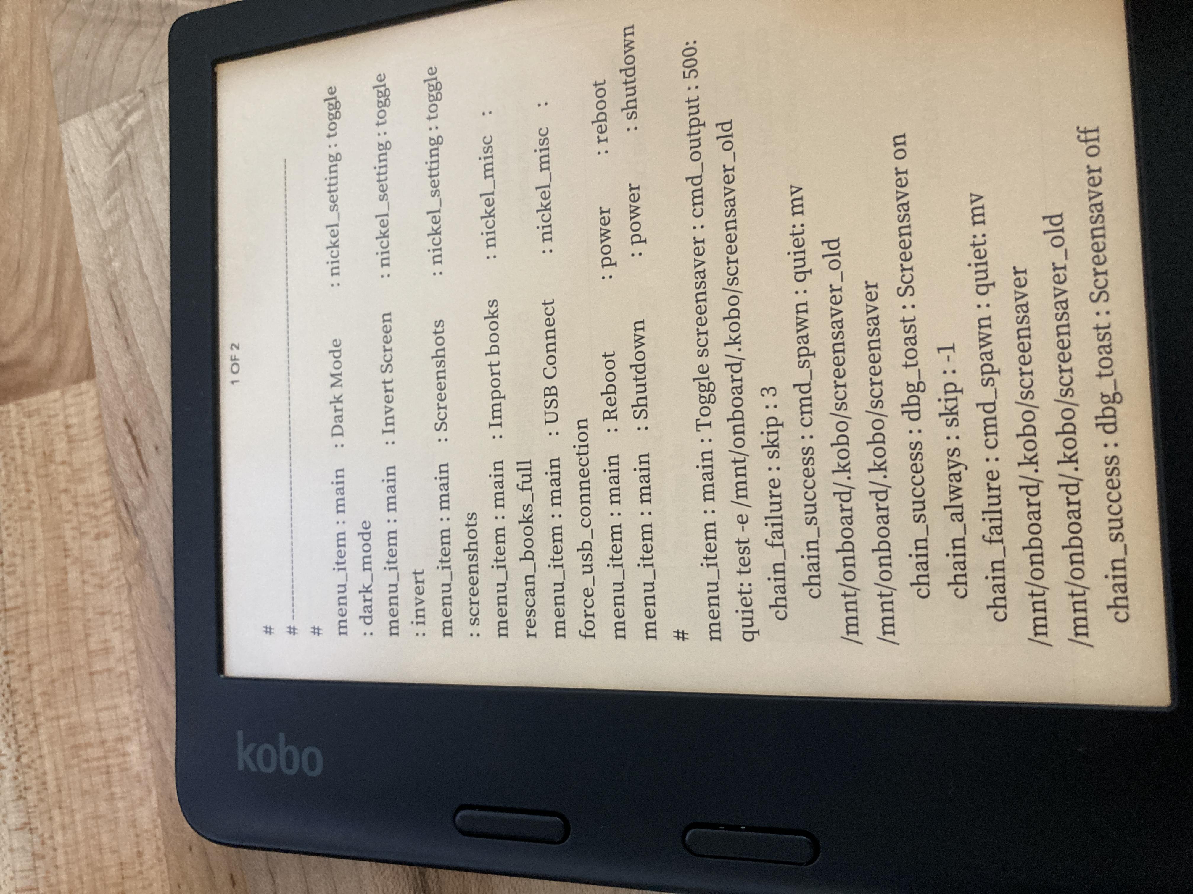

Thanks David. I copy-pasted your sample config into the config file under .adds/nm/ and loaded KoboRoot.tgz again and still, no new menu item appear in the main menu. What's funny is that the config ended up appearing in my book lists which I can open and see the content.
To me, it looks like you have extension .txt in that file you now see as a text (ebook).
According to instructions in first post:
Connect you Kobo eReader to your computer again and create a new file (of any type) named KOBOeReader/.adds/nm/config, and follow the instructions in KOBOeReader/.adds/nm/doc to configure NickelMenu.
So, file should have no extension.
Alan_S is offline   Reply With Quote

The extension doesn't matter and what h_nara needs to do is to add a line to the Kobo eReader.conf file under the [FeatureSettings] header. NM will read any files in that directory and add any uncommented menu items to the menu.
[FeatureSettings]
ExcludeSyncFolders=\\.(?!kobo|adobe).*?
