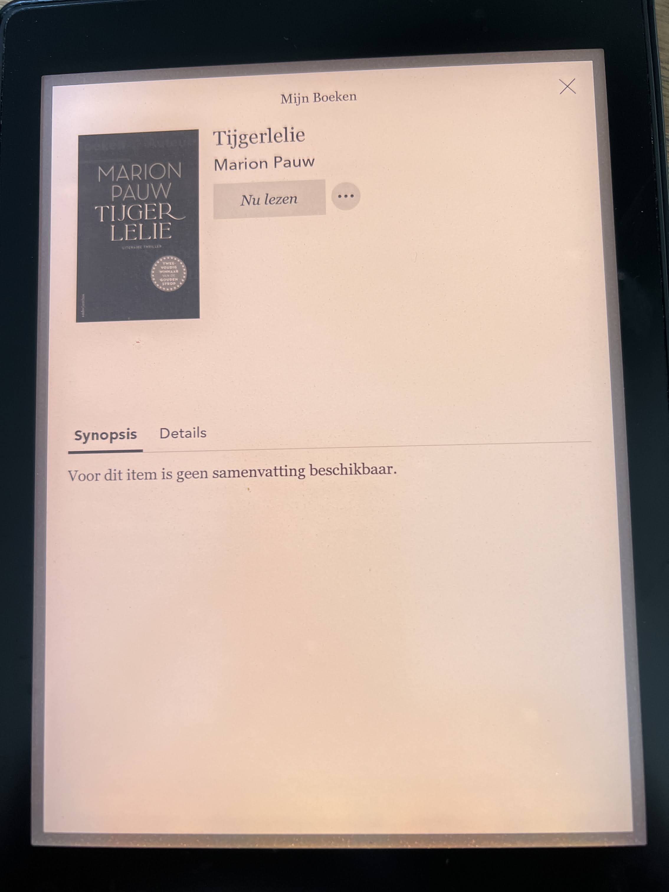

I have a Kobo Aura One and been using Calibre for a long time.
lately i have trouble getting Summary's on my reader
The summary is visible in Calibre
I convert the epub's to kepub and then sent the books to my reader
What is wrong ? Am i missing something ?
help is appreciated. Could not find anything on the forum's

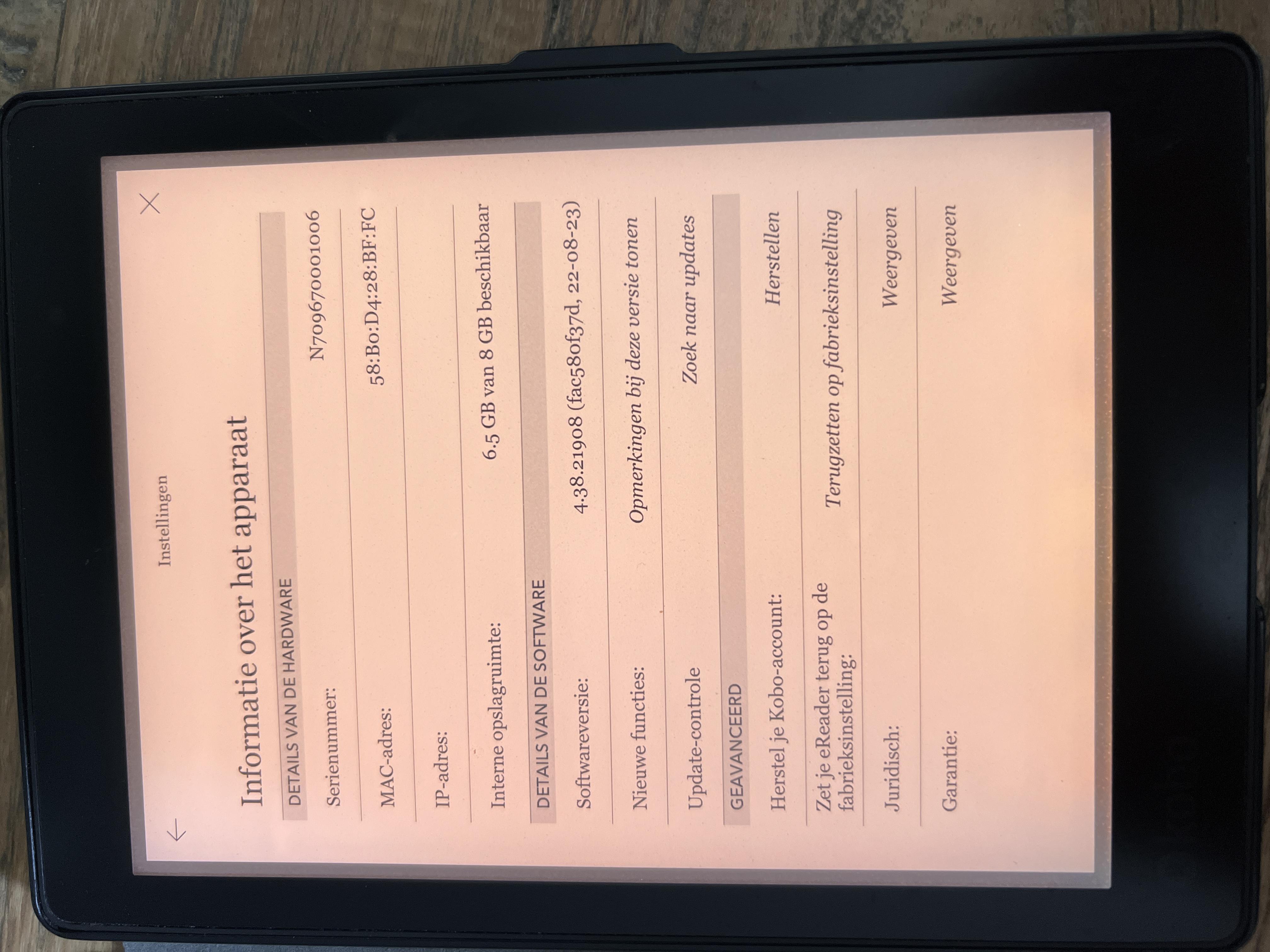

Kobos take a second connection AFTER you see processing (after ejecting the first time)
AFAIK your synopsis needs to be showing in Calibre COMMENTS for this to work.
Also, what firmware is on your Kobo??

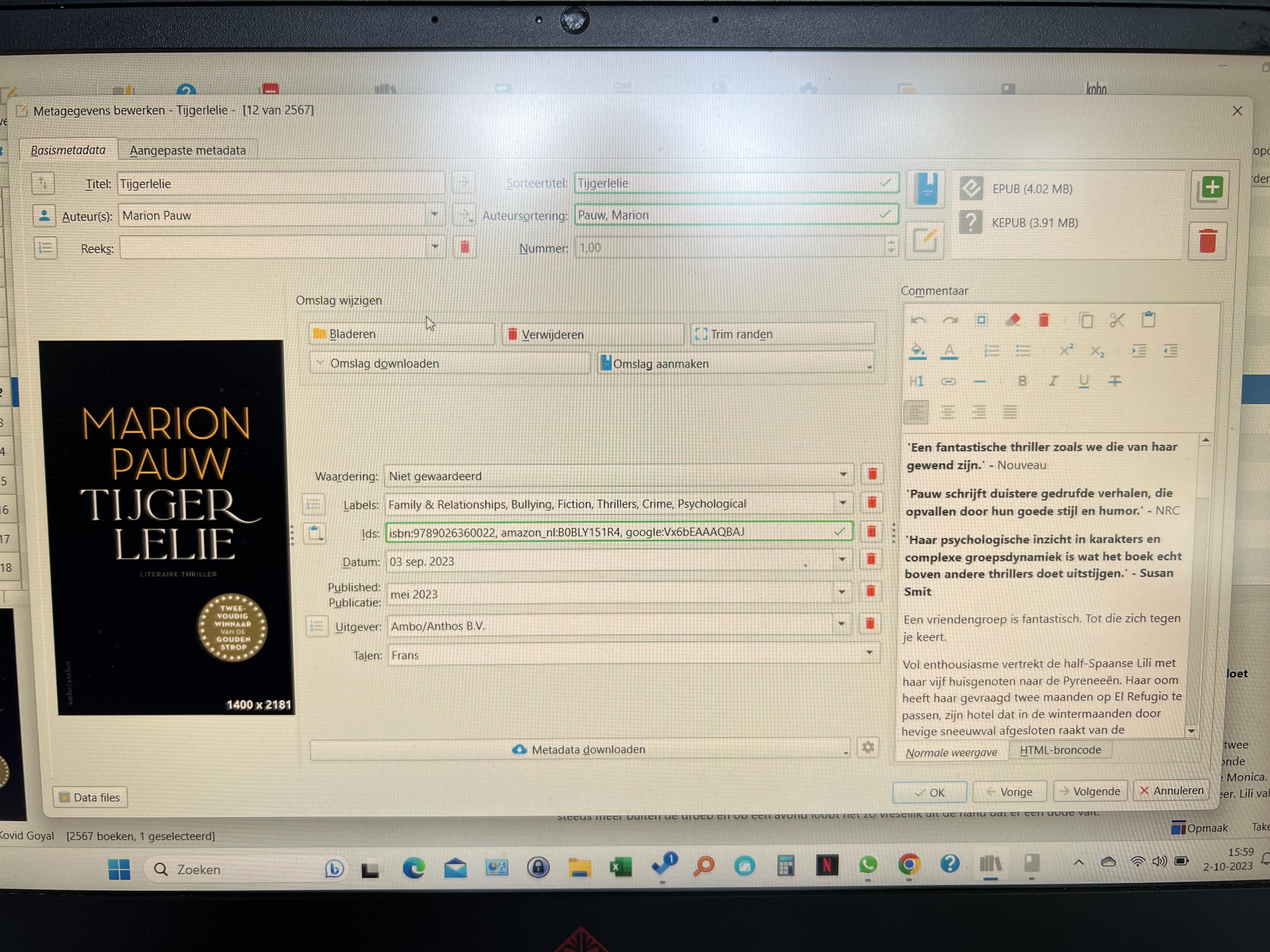

Hi
thanks for thinking with me. See the attached files.
Checked your suggestions but the seem to be ok.
The only thing other than your screenprint was that the metadata management was set to manual in stead of automatic . Changed that to automatich but no result

If you have KoboUtilities installed, you might want to try connecting your Kobo, selecting all the books that show as on device and then using the Update metadata in device library to force an update of the transferred metadata.

After you set metadata management to automatic, did you plug your Kobo into the computer with calibre running with your library loaded?

Hi DNSB !
your option did the trick ! Thanks !!
