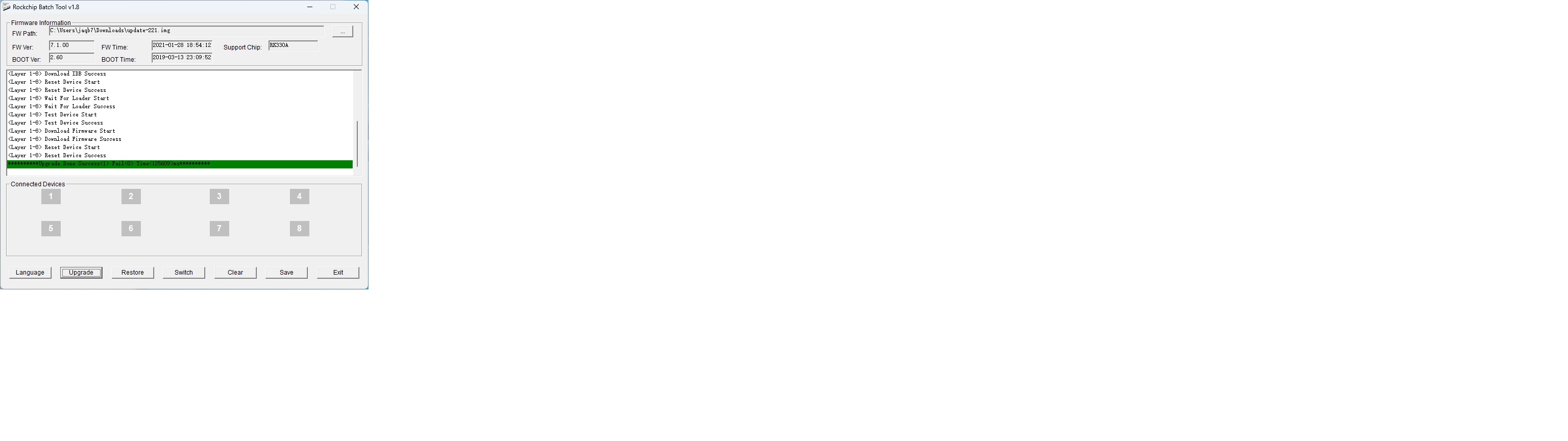

Hi every one. I try update my Mimas T103D with firmware to 3.1.1 and during flash every think was ok.
https://ibb.co/0YQ9YCR
After this I saw on screen message "android erasing" and some secs letter my book reader was death. What can I do ? Maybe anyone can have previous old firmware 2.3.3 ?
Regards

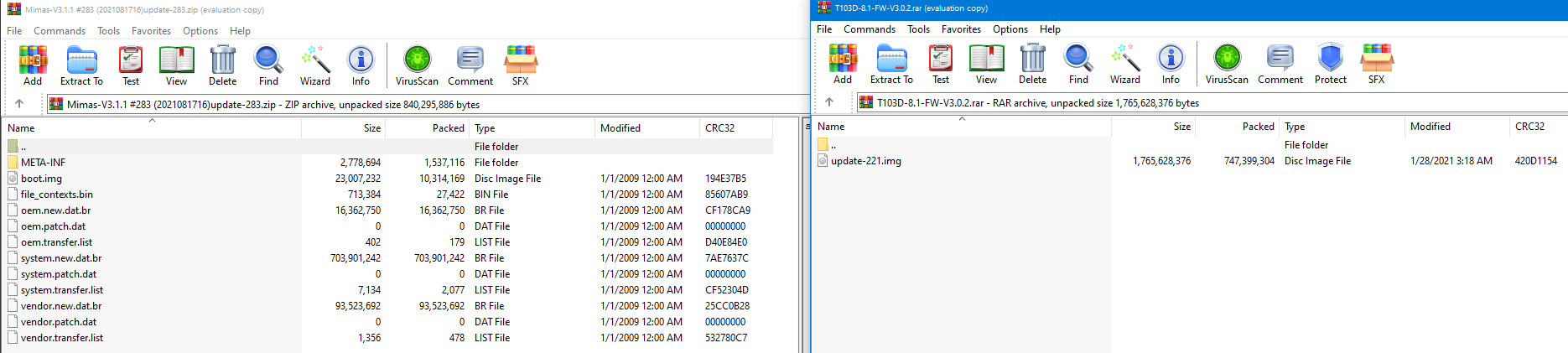

Originally Posted by jaqb View Post
correcting my previous post - to firmware V3.0.2 (update-221.img)
Have you tried to just rerun the flashing process? The 221 img should be the full 3.0.2 and wipe the device in the process then you can take update 283 (3.1.1) which is a normal update.zip that is ran off the mimas as an OTA.
Are you able to get back into the Bootloader for flashing again?
