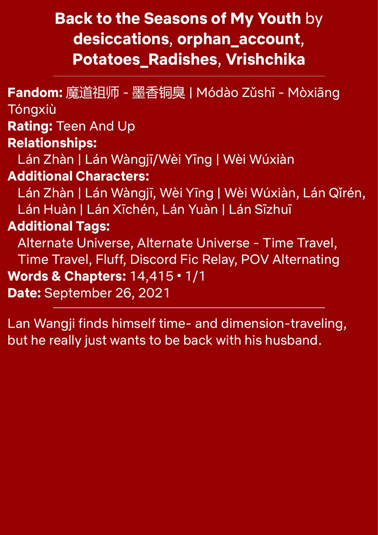

Old 06-03-2023, 10:08 AM   #42
culytera
culytera ought to be getting tired of karma fortunes by now.culytera ought to be getting tired of karma fortunes by now.culytera ought to be getting tired of karma fortunes by now.culytera ought to be getting tired of karma fortunes by now.culytera ought to be getting tired of karma fortunes by now.culytera ought to be getting tired of karma fortunes by now.culytera ought to be getting tired of karma fortunes by now.culytera ought to be getting tired of karma fortunes by now.culytera ought to be getting tired of karma fortunes by now.culytera ought to be getting tired of karma fortunes by now.culytera ought to be getting tired of karma fortunes by now.
Posts: 182
Karma: 295686
Join Date: Jul 2021
Device: iPhone
With my settings, this is what the front page looks like. The result seems to be as expected. I actually don't use the "genre" tag for Ao3 and just use the separate tags for them.
[archiveofourown.org]
category_label:Fandom
include_in_genre:
## freeformtags, ao3categories
use_view_full_work:true
ao3categories_label:Category
chapterslashtotal_label:Chapters
keep_in_order_ao3categories:true
add_to_custom_columns_settings:
 chapterslashtotal=>#ao3_chapters
add_to_replace_metadata:
 ## Changes line breaks to paragraphs
 description=>(<p>[-+*;.]*<\/p>)+=>
## Items to include in the title page
## Empty metadata entries will *not* appear, unless .SHOW_EMPTY is
## appended.  Eg: titlepage_entries: ..., characters.SHOW_EMPTY,
## ships,... will always display Characters, but only show
## Relationships if there are any.  You can include extra text or HTML
## that will be included as-is in the title page. Eg:
## titlepage_entries: ...,<br />,summary,<br />,...
## All current formats already include title and author.
titlepage_entries:<div class="inline">,seriesHTML,category,rating,warnings,</div>,ships,additional_characters,freeformtags
## metadata ${title}, etc.  Make sure to keep at least one space
## at the start of each line and to escape % to %%.
titlepage_start:<?xml version="1.0" encoding="UTF-8"?>
 <!DOCTYPE html PUBLIC "-//W3C//DTD XHTML 1.1//EN" "http://www.w3.org/TR/xhtml11/DTD/xhtml11.dtd">
 <html xmlns="http://www.w3.org/1999/xhtml">
 <head>
 <title>${title} by ${author}</title>
 <link href="stylesheet.css" type="text/css" charset="UTF-8" rel="stylesheet"/>
 <meta name="calibre-html-render-data" content='{"size": "A2", "margins": [0, 0, 0, 0]}'/>
 </head>
 <body class="fff_titlepage" style="font-size: 2.5vmax;">
 <div class="title">
 <h1><a href="${storyUrl}">${title}</a> by ${authorHTML}</h1>
 </div>
 <hr/>
 <dl class="tags">
## ${id}, ${label}, ${value}
titlepage_entry:
 <dt><b>${label}:</b></dt> <dd>${value}</dd>
## Used with entries listed in wide_titlepage_entries, typically description, storyUrl, authorUrl
titlepage_wide_entry:
## When using tables, make these span both columns.
wide_titlepage_entries:
## ${id}, ${value}
## For example, if you've set description_label:
## (that is, nothing)
titlepage_no_title_entry:
## metadata
titlepage_end:
 <dl class="stats">
 <dt><b>Words &amp; Chapters:</b> ${numWords} &bull; ${chapterslashtotal}</dt>
 <dt><b>Date:</b> ${dateRange}</dt>
 </dl>
 </dl>
 <hr/>
 <div class="tag-summary-content">${description}</div>
 </body>
 </html>
Name:	Back to the Seasons of My Youth.jpeg
culytera is offline   Reply With Quote
Old 06-04-2023, 04:01 AM   #43
Amalthia
Amalthia ought to be getting tired of karma fortunes by now.Amalthia ought to be getting tired of karma fortunes by now.Amalthia ought to be getting tired of karma fortunes by now.Amalthia ought to be getting tired of karma fortunes by now.Amalthia ought to be getting tired of karma fortunes by now.Amalthia ought to be getting tired of karma fortunes by now.Amalthia ought to be getting tired of karma fortunes by now.Amalthia ought to be getting tired of karma fortunes by now.Amalthia ought to be getting tired of karma fortunes by now.Amalthia ought to be getting tired of karma fortunes by now.Amalthia ought to be getting tired of karma fortunes by now.
Amalthia's Avatar
Posts: 1,213
Karma: 1041798
Location: Anchorage, AK
Device: Sony Reader PRS-505, PRS-650, PRS-T3, Pocketbook HD2
Hi,
Do additional tags download and appear on your title page and additional tags column if the story is restricted?
Thanks,
Amalthia
Amalthia is offline   Reply With Quote

Originally Posted by Amalthia View Post
Hi,
Thanks,
Amalthia
I don't use an additional tags column in Calibre, but the title page I attached is from the restricted story you linked and it has the additional tags. "freeformtags" is what FFF calls ao3's additional tags, so I renamed freeformtags' label to "Additional Tags" and added freeformtags to titlepage_entries as shown on my previous post.
Originally Posted by Ghostcat View Post
I really liked culytera's titlepage so I thought I would adopt it. However, titlepage_start doesn't appear to work as advertised. I am probably missing a setting somewhere. This is the resultant HTML: [...]
That might be because of additional css changes I made which weren't included in the code I shared. Here it is
add_to_output_css:
 body {
  font-family: 'Netflix Sans', sans-serif;
  text-align: left;
 body.fff_titlepage {
  background-color: #980101;
  color: white;
 hr {
  display: block;
  border: 0; border-top: 1px solid;
  padding: 0; width: 75%%;
 .fff_titlepage .title h1,
 .fff_titlepage .title h2 {
  font-size: 3vmax;
  margin: 0;
 .fff_titlepage .title h1 { font-weight: normal; }
 .fff_titlepage .title h1 a { font-weight: bold; }
 .fff_titlepage .title a,
 .fff_titlepage .tags a,
 .fff_titlepage .tag-summary-content a {
  text-decoration: none;
  color: unset;
  font-style: italic;
 .fff_titlepage .tag-summary-content p {
  margin-top: 0;
 .fff_titlepage .tags {
  display: block;
  padding: 0;
 .fff_titlepage dl .inline dd {
   display: inline;
   margin: 0;
 .fff_titlepage dl .inline dd:after {
   display: block;
   content: '';
 .fff_titlepage dl .inline dt{
   display: inline-block;
 .fff_titlepage dd { margin-left: 0.75em; }
 .fff_titlepage dl, .fff_titlepage dt { margin: 0; }
