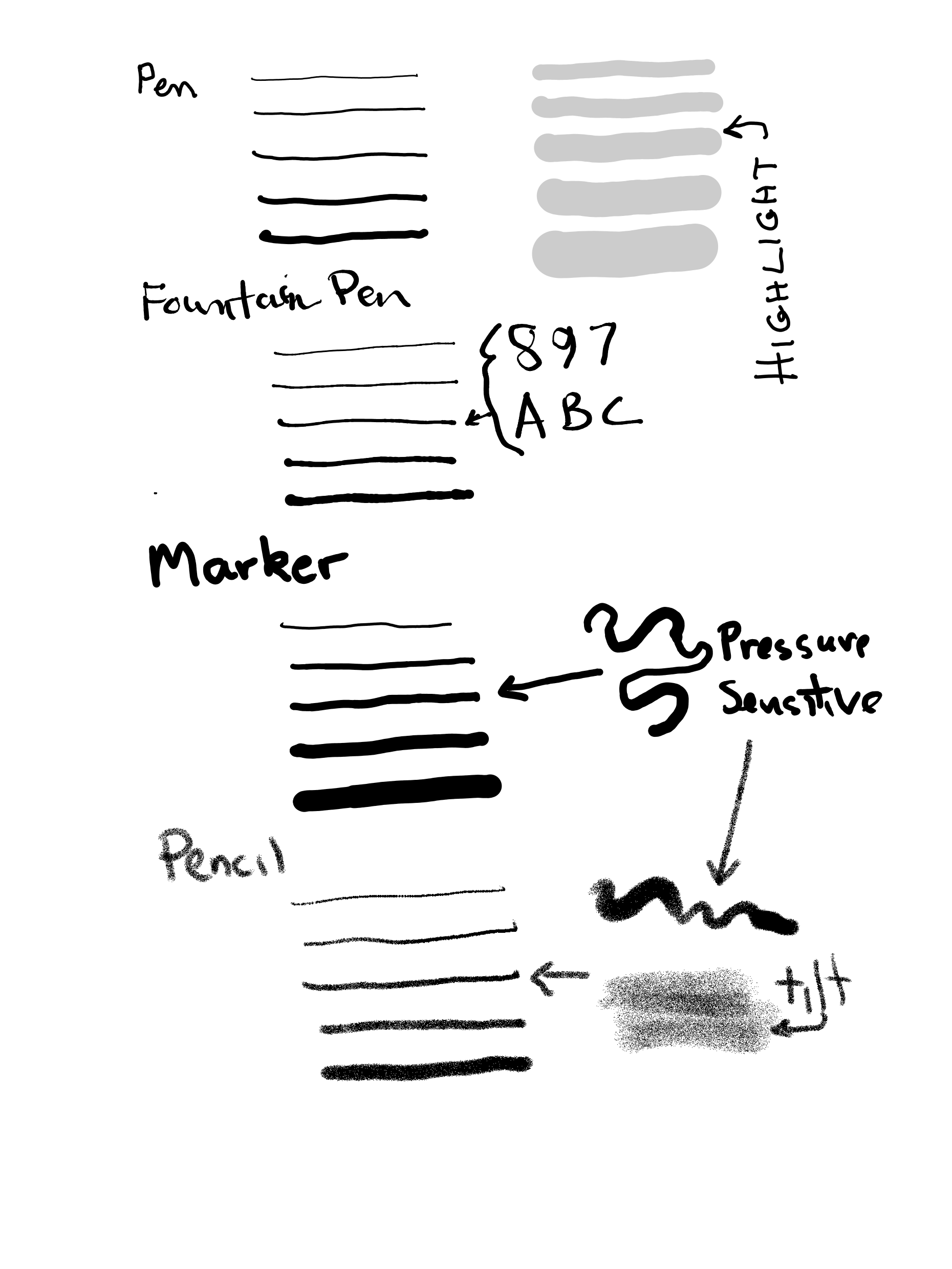

Here you go.
I do not see any 'stroke colors' for any of the line types or for the highlighter. It can't be the pressure measure either, since that has a larger range of values.
There is at least a need for other colors (including white) when writing on black/dark ('PDF') backgrounds. But I don't see it anywhere. Maybe they'll turn this on one day when we're not paying attention. (I assume Dark Mode does not change any properties and just automatically inverts color)

Originally Posted by tomsem View Post
Here you go.
Thanks for that sample. It helped to fill in some of the gaps in my understanding.

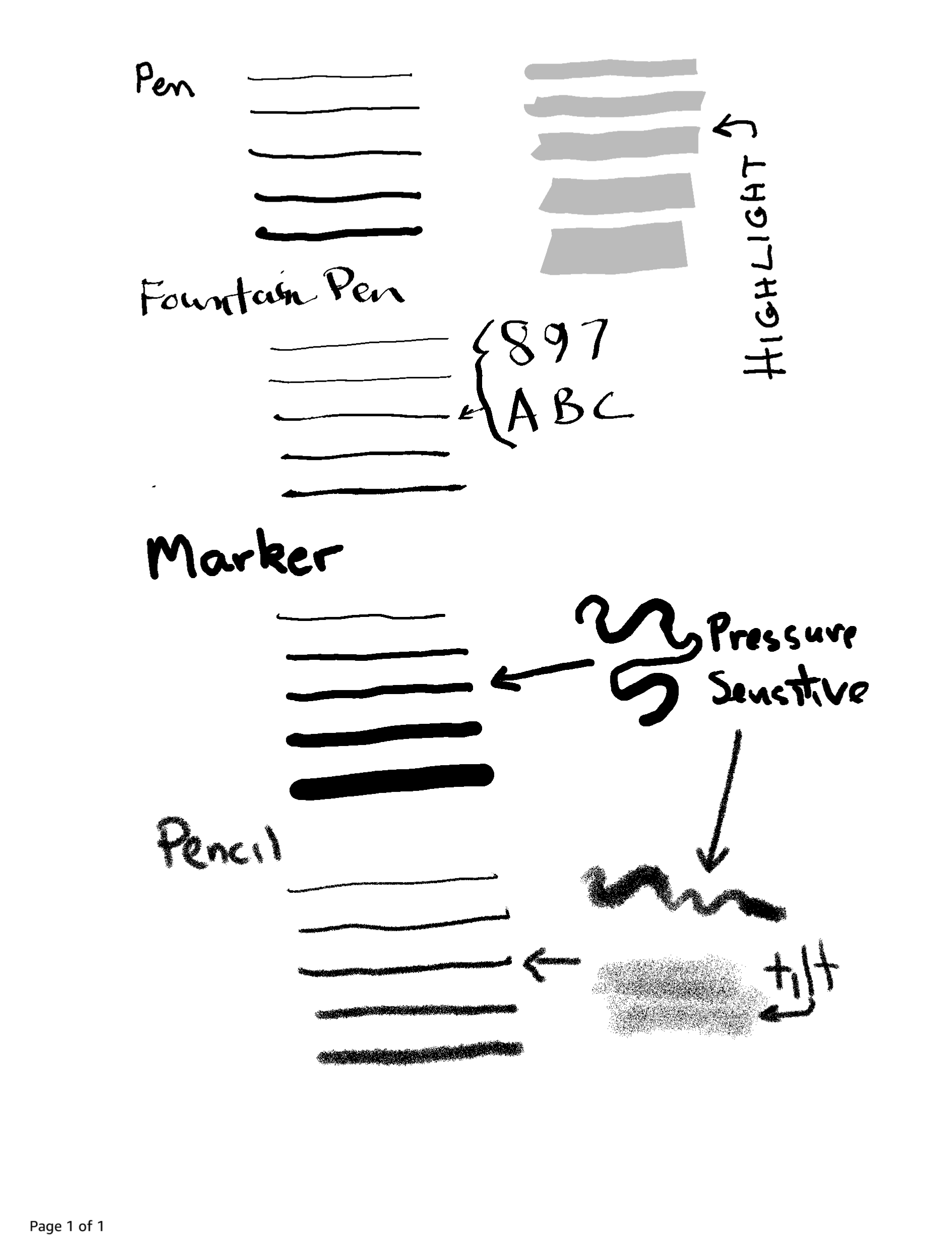

I been tweaking my rendering of strokes as SVG and it is still a work in progress. I am attaching two images. The first is the PNG from your Scribe showing Amazon's rendering of your sample page. The second is a PNG produced by rasterizing the SVG produced by my plugin. There are noticeable differences especially in the highlighter and pencil strokes.

It definitely was a menu choice in the firmware. It is likely something that isn't finished yet or that they decided to not release for some reason.
