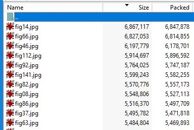

VERY slow convert ePub to KFX
I have several epub books by the same author, approx same file size.
Four convert in 1-2 minutes, 1 runs for hours -- hits 67% and just sits there
I tried epub-to-epub conversion, ModifyePub, replaced fonts with TTF, but still takes long time
Enventually I just cancel the job
Kindle Perviewer 3.72, Calibre 6.17 64 bit, Windows 10 64 bit, KFX Output PI 1.67
Is there some ePub content(s) that would take a long time to convert?
The log shows that the Kindle Previewer was still running.
It is possible, but unlikely. You could try letting it run overnight to be sure. Otherwise there is likely something about that EPUB that is causing the Kindle Previewer to get hung up on it.

Old 05-25-2023, 09:40 PM   #1357
phossler
Posts: 1,098
Karma: 447222
Device: Kindle Paperwhite
Thank you very much
I don't know if it matters, but the scrambled file is 14.14 MB and the original is 440.83 MB
There are a LOT of images in the original
So maybe it was just the size and I needed to be more patient
Like I said, all the others that I was converting to side load onto my Kindle converted very nicely and in 30 - 90 seconds
Scrambling replaces all of the images with generic ones that can be larger than the originals.
I was able to convert the scrambled file on my PC in about a minute. Can you confirm that the scrambled file still takes a long time for you?
Old 05-26-2023, 12:16 AM   #1359
phossler
Posts: 1,098
Karma: 447222
The scrambled version (14.14 MB) converted in 1 min 48 sec so maybe it was all of the very large images in the original epub (440.83MB)??
Edit
I edited the scrambled epub and replaced 12 of the generic images with 12 (67MB) of the real ones. This made the scrambled epub much larger (of course) 75MB
Converting the edited scrambled epub took 4:30 so I guess run time is very dependent on the number and size of the images
That seems likely.
