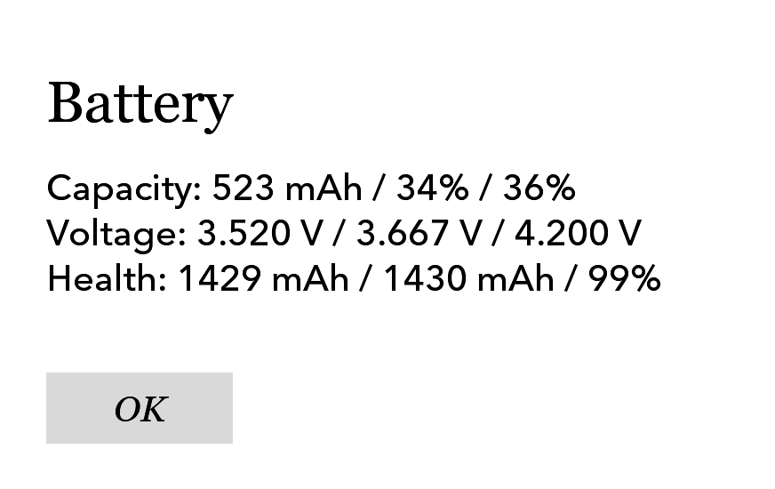

Originally Posted by isarl View Post
After some tinkering with telnet, I figured out how to make an ugly but functional battery status option with NickelMenu.
menu_item :main :Battery :cmd_output :500 :cat /sys/class/power_supply/battery/capacity /sys/class/power_supply/battery/voltage_now /sys/class/power_supply/battery/voltage_min /sys/class/power_supply/battery/voltage_max /sys/class/power_supply/battery/charge_now /sys/class/power_supply/battery/charge_full /sys/class/power_supply/battery/charge_full_design
This will generate a pop-up window containing:
  • The current charge as a percentage
  • The current voltage
  • The minimum voltage
  • The maximum voltage
  • The current capacity (mAh)
  • The maximum capacity
  • The maximum design capacity
The pop-up window will look like this (but without the key):
39
3707800 (3.71 V)
3520000 (3.52 V)
4200000 (4.20 V)
590000  (590 mAh)
1429000 (1429 mAh)
1430000 (1430 mAh)
You may be able to guess that this output is from my Libra 2 by the battery capacity.
You can track the decline in the voltage as the battery discharges, and you can track the health of your battery by comparing the maximum capacity against the design capacity. You can also double check the calculated percentage by dividing (current capacity / maximum capacity). In this example, the capacity indicates 41%, but the battery meter claims 39%.
Of course, this assumes that sysfs actually produces reliable numbers, but at least it's more information than the default battery meter gives us.
If any Linux gurus out there can tell me how I could intercept the output of cat and format it nicely instead of displaying the raw numbers, I'd be interested to try that.
Depends on what's available. If units is available then something like:
# Example just echoing a number to test the concept.
# Use 'units' --terse mode.
# Convert from uV to V.
# Then echo it along with a literal V.
echo $(units -t "$(echo 3707800) uV" V) V
# result: 3.7078 V
# Replacing the call to echo with your call to cat:
echo $(units -t "$(cat /sys/class/power_supply/battery/voltage_now) uV" V) V
If units is not available but sed is available, and we are just dividing by 1e6 or 1e3 (which seems to be the case) then perhaps something like:
# The idea is to look for 6 or 7 digits, and insert a dot before the final 6 digits.
# If it was 6 digits then a leading 0 is inserted before the decimal.
# Trailing zeroes in the fractional part are stripped.
# If this results in a number like "3." then a single trailing zero is added, e.g. "3.0".
# Finally the line has the units appended on.
# Example using echo:
echo 3707800 | sed -E -e 's/([0-9]?)([0-9]{6})/\1.\2/; s/^\./0./; s/\.([0-9]*[1-9])?0+/.\1/; s/\.$/.0/; s/$/ V/'
# result: 3.7078 V
# With the actual file:
cat /sys/class/power_supply/battery/voltage_now | sed -E -e 's/([0-9]?)([0-9]{6})/\1.\2/; s/^\./0./; s/\.([0-9]*[1-9])?0+/.\1/; s/\.$/.0/; s/$/ V/'
Dividing by 10e3 is similar:
# Here if the result has no fractional part it is omitted instead of shown as ".0".
echo 1429000 | sed -E -e 's/([0-9]{3,4})([0-9]{3})/\1.\2/; s/^\./0./; s/\.([0-9]*[1-9])?0+/.\1/; s/\.$//; s/$/ mAh/'
# result: 1429 mAh
cat /sys/class/power_supply/battery/charge_now | sed -E -e 's/([0-9]{3,4})([0-9]{3})/\1.\2/; s/^\./0./; s/\.([0-9]*[1-9])?0+/.\1/; s/\.$//; s/$/ mAh/'

Sadly, the units command is not available. Is it possible to run commands and store the output in variables the way you can if you're directly interacting with the shell, or are you required to perform every operation in one line? If I use one cat and one sed at a time, then it seems like I'd have to generate multiple pop-up windows to display all the information. I don't see any mention in the documentation of being able to pass the output of one command as the input for a chain_success command, either.
Alternatively, could I put everything into a shell script inside /mnt/onboard/.adds/ and then execute that with cmd_output?
That should work. It doesn't have to be in .adds/ in particular, but that seems like a logical place.
Success! Thanks for all the help. If anyone's interested, here's the script:
# Battery Statistics Calculator 1.0 (2023-05-18) by Aleron Ives
# This script calculates battery statistics for the Kobo Libra 2.
# Check the contents of /sys/class/power_supply/ if you use a different
# model to ensure that the statistics you want to track are available.
# You can use NickelMenu to invoke this script like so:
# menu_item :main :Battery :cmd_output :500 :/mnt/onboard/.adds/battcalc.sh
# Gather the necessary statistics
meter=$(cat /sys/class/power_supply/battery/capacity)
v_now=$(cat /sys/class/power_supply/battery/voltage_now)
v_min=$(cat /sys/class/power_supply/battery/voltage_min)
v_max=$(cat /sys/class/power_supply/battery/voltage_max)
c_now=$(cat /sys/class/power_supply/battery/charge_now)
c_full=$(cat /sys/class/power_supply/battery/charge_full)
c_dfull=$(cat /sys/class/power_supply/battery/charge_full_design)
let v_now/=1000; let v_min/=1000; let v_max/=1000 # Convert to V
let c_now/=1000; let c_full/=1000; let c_dfull/=1000 # Convert to mAh
let v_nowr=$v_now%1000; let v_now/=1000 # Simulate floating-point arithmetic
let v_minr=$v_min%1000; let v_min/=1000 # "
let v_maxr=$v_max%1000; let v_max/=1000 # "
let charge=$c_now*100/$c_full # Calculate charge percentage from mAh
let c_health=$c_full*100/$c_dfull # Calculate health percentage from mAh
# Format and display the results
echo Capacity: $c_now mAh / $meter% / $charge%
echo Voltage: $v_min.$v_minr V / $v_now.$v_nowr V / $v_max.$v_maxr V
echo Health: $c_full mAh / $c_dfull mAh / $c_health%
Now you get lots of new inaccurate statistics! Kobo is using BusyBox with ash, so I had to do some research on how it works, but it seems to be mostly the same as bash. I've attached a picture of the output on the Kobo.
You get the current battery capacity in mAh, the current percentage that the battery icon reports, the current percentage as calculated by the current / maximum mAh, the minimum, current, and maximum battery voltage, and the battery health calculated from the maximum vs the design capacity.
