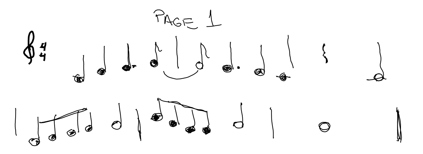

Old 05-18-2023, 09:10 PM   #26
jhowell
jhowell's Avatar
Posts: 7,445
Karma: 96111109
Location: Charlottesville, VA
Device: Kindles
Originally Posted by tomsem View Post
Here is a zipped up folder for a notebook.
I have been examining the notebooks you uploaded and through trial and error have had some success at decoding the blobs that hold stroke data and converting them to SVG images. It is still a work in progress.
I am attaching a zipped SVG image along with a rasterized JPEG version of the first page of the 61233b77-330b-5427-4581-5f977d998bb5 notebook.
At present the conversion includes only the hand drawn strokes, not the background template. It looks pretty good to me, but I don't have the original to compare it to.
I created a very simple notebook with 5 strokes: Pen, Fountain pen, Marker, Pencil, and Highlight using the blank page template. Except for variations in stroke weight, pressure, tilt I think these are the only entities you can create currently with Pen.
I have been able to decode some more data variations from that, but it isn't making complete sense so far. It is a work in progress.
At this point I am planning that the next release of the KFX Input plugin will be able to convert Scribe notebooks to EPUB format with each page containing an SVG image with a fairly accurate representation of the user's drawing along with the template background.
