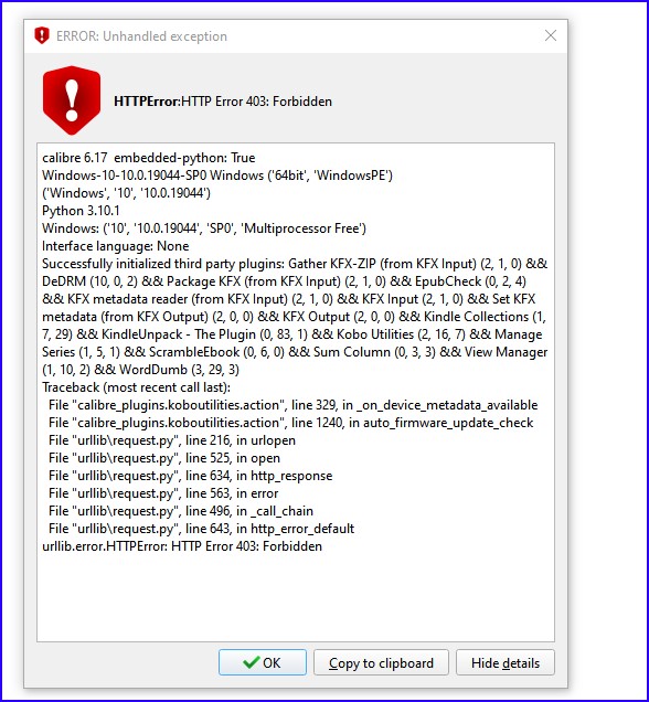

I receive an error 403 which I reported in this thread... https://www.mobileread.com/forums/sh...21#post4336221
@DNSB believes it is a problem with the Kobo Utilities plugin
Attachment 202384

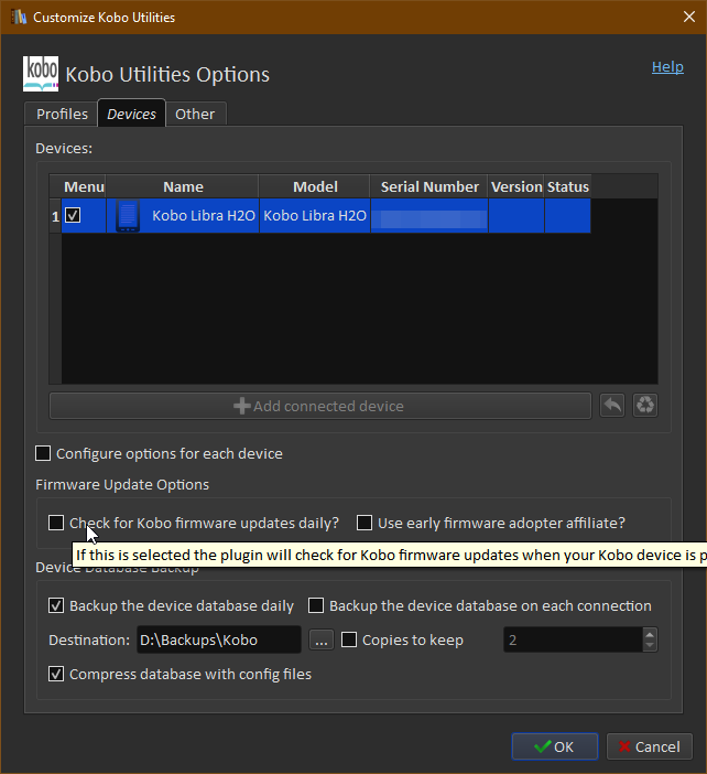

You can disable it here until somebody can get it fixed.
Name:	2023-07-01 23_16_58-Customize Kobo Utilities.png
Basically, when I noticed the error, I tried a couple of firmware updates from KoboUtililities dropdown menu. This triggered the error each time. Since Kobo had mentioned making changes which would force using a 4.35+ firmware version to continue using their website, I felt it was a pretty safe bet that this change was triggering the issue with KoboUtilities.
Great. Thanks
